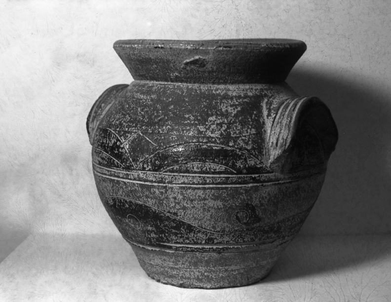

If anyone is interested, I used HC-110 at 1:79 for 10 min @ 75 degrees. Very acceptable. Not sure how to post the pic??
bartnav
Mar 23, 2010
9
Pic of jar
I think it's posted
