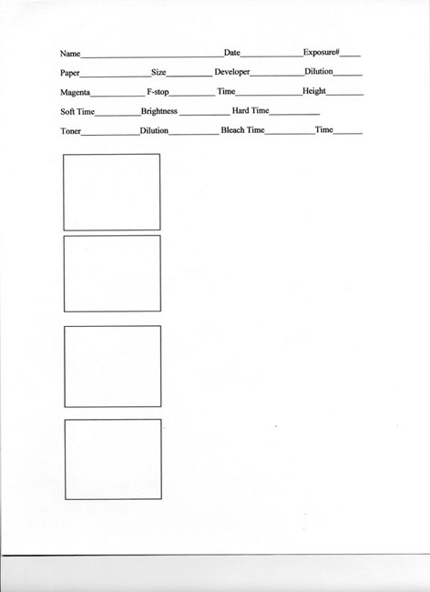

This is what I use. In the boxes I draw where the burn/dodge areas are and for how much time.
Michael
Michael
Michael,
I like the form -- the fields of "soft time" and "hard time" bring to mind visions of a split filtered justice system where prisoners are sentenced to soft time in a minimum security institution, and hard time in somewhere like Fulsom. :smile:
