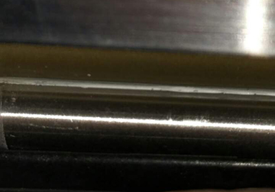

    So I just got an SX-70. I didn't know if the seller sent to me an empty cartridge, so I opened the film door to see it. I took it off and inserted it again... The cartridge is old and it seems that it doesn't have enough battery by the slow noises that the camera made. Now I think the mirror is stuck (I only can see half of the "picture" through the viewfinder), the film is stuck in the rollers, and the problem is that I can't open the film door.
    What should I do? [​IMG]

    I'm having some trouble trying to pull the film out. As you can see, it is only a few mm outside. Do you have any other suggestions if I can't pull it off?
