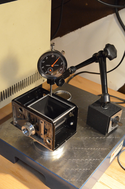

It won't make any difference if the 6x6cm camera does not have adjustable centering detents and you don't have a way to align it to fractions of a millimeter.
A typical 6x6cm camera would be spec'd around 0.02 to 0.05mm tolerance for the film plane to lens board.
Image below from https://www.optomeca.fr
