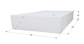

Fresh water tank for a RV by cutting one side and mounting in a 2x4 frame?

My back of a virtual envelope calculations indicate that that would hold 130 US gallons, which means a weight of water ~ 1,300 pounds.

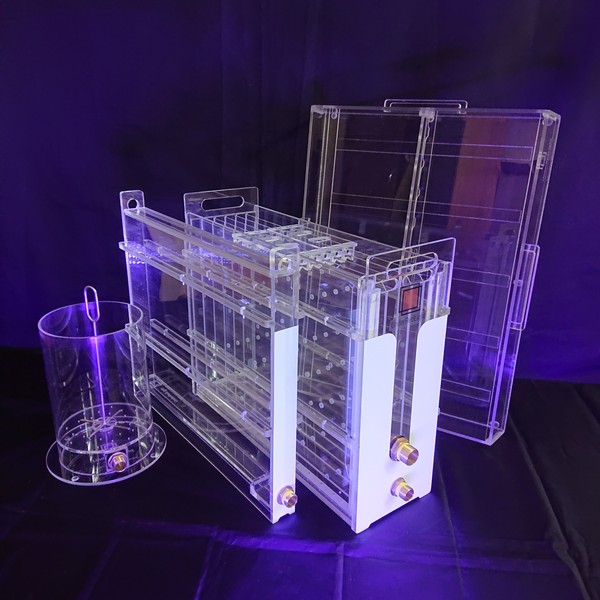

I was doing some research on the old Calumet Gravity Works print and film washers and came across a fellow in the Ukraine that makes these types of washers. His website shows some interesting print washers designs. I don't know how large he builds but is an interesting read.
