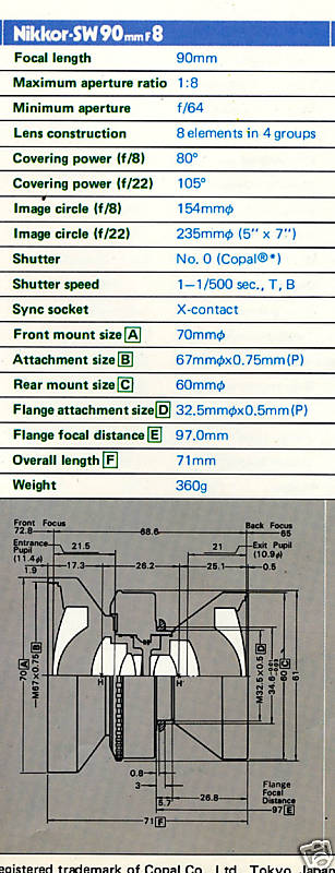

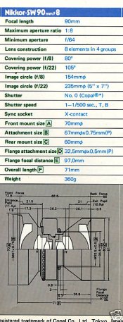

  8. Fotoguy20d
    Fotoguy20d Subscriber
    Messages:
    1,250
    Joined:
    Jan 23, 2008
    Location:
    NJ
    Shooter:
    If the attached data sheet is to be believed, the Nikkor-SW 90mm f8 is symmetrical. The lens does fit into a Speed/Crown graphic, but, of course, you aren't going to close it up with the lens board in place.
    Dan
