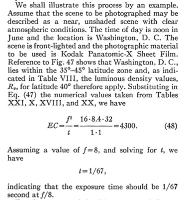

Sunlight and Skylight as Determinants of Photographic Exposure, 1948, Jones and Condit

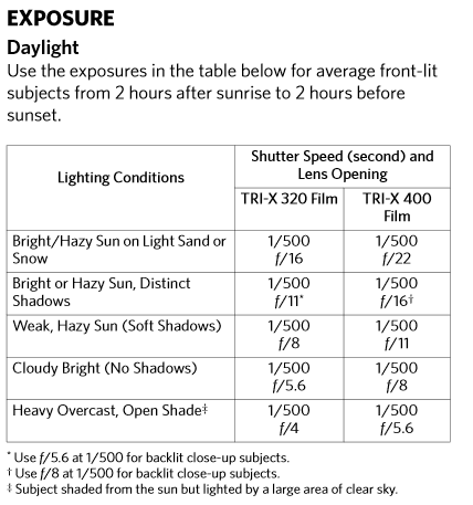

In this APUG thread from a few months back, Ralph Lambrecht posted this handy exposure table:
So, for a bright subject, f/22 would be appropriate. But for normal, then f/16 is better and f/11 for darker subjects. In your environs, maybe "sunny 11" is better.
