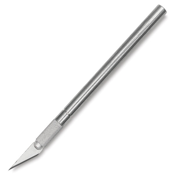

How do I take the black cover from the cocking lever?
onre
Nov 18, 2015
343
Toijala, Finland
I used a small "hobby knife" to get it off, putting it in between the black part and the lever and carefully prying a bit from different places on the rim until the cover lifted off.
Dinis Figueira
May 4, 2016
182
Portugal
I can't get any knife to go there. They are too thick...
onre
Nov 18, 2015
343
Toijala, Finland
These usually have narrow enough tips to work.
