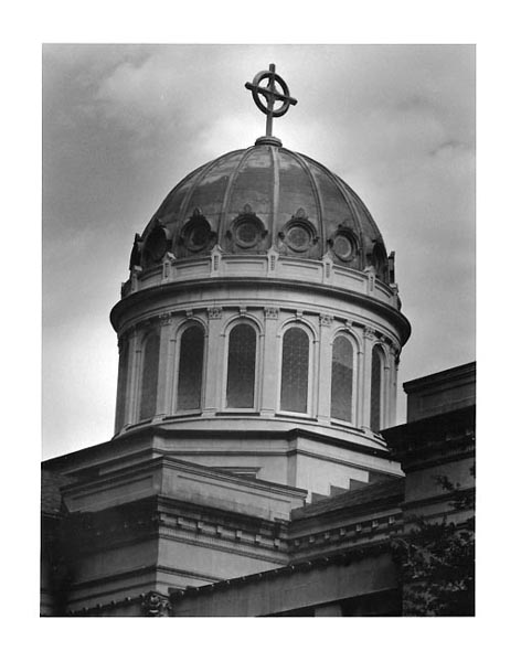

Rodinal 1:100 Semi-Stand Develpment
roy said:
photomc said:
also - does semi-stand development work well with roll film
In my experience, it does. In the thread "FP4+ grain in Rodinal" of a few weeks ago, I mentioned that I had successfully developed an out of date film in several years old developer. I did not give it 30 minutes, more like 20 but the whole thing was an experiment and, although there was nothing on the film that was of major importance, the whole film was good and each shot was a bonus. Shoot off a spare film and try it.
Well, went out today and shot a roll of FP4+, then developed it in Rodinal 1:100, 30 minutes agitation was maybe every 8 minutes for 10 seconds. First thing I noticed was the developer came out pretty yellow, which was a little more noticeable than 1:50 or so. The negatives came out nice..now I must admit the test was a bit of a bust for the following reasons..forgot my light meter so exposure was base off of 'Sunny f/16', EI was 64. Then I seem to have something either in the camera or on the insert that keeps scratching the film, and last of all the light was flat - overcast, hazy, etc.
I will try to attach photo, if not will add it to technical gallery.

photomc said:
Well, went out today and shot a roll of FP4+, then developed it in Rodinal 1:100 First thing I noticed was the developer came out pretty yellow, which was a little more noticeable than 1:50 or so. The negatives came out nice
At least you have something to go on if you wish to experiment more. I have to say that my Rodinal started dark brown and the colour only improved with dilution !

Nice photo, is the "halo" around the church something you expected?
It seesm to me that the clouds around it are much brighter than the rest.
