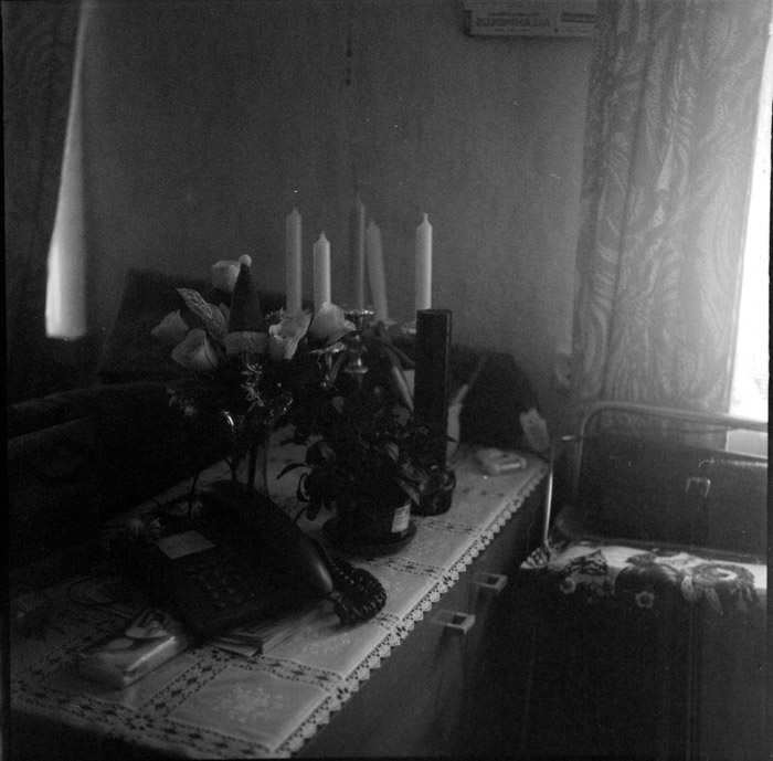

Tri-X stand-developed gave me results such as this:
...but I can get HP5 or Neopan 400 cheaper, so I want to know how well these films stand-develop.

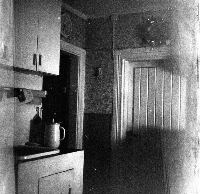

Okay, here they are. Hp5 shot at 12800. Developed in the new Fomadon R09 1:100 for about 3 hours and 30 minutes. Good, bad, and the worst.
I measured the light with a Canon SLR set at 6400 and took off one additional stop, to make it 12800. I think the worst image shows what HP5 at 12800 actually is, and the others look better because of the "brighter" light available. Someone smarter can say what exactly is happening. I shot this roll almost 2 years ago.
I will add, that I first agitated for about 40 seconds, and at about 2h45min mark I made a slow and gentle half-twirl.
So you didn't agitate at all between the first minute and the 2h45min mark?
The last one is quite good.
I will test my HP5 at 6400 by bracketing shots and I'll see what that gets me. It seems that there has to be a minimum amount of light available to the film before stand development can bring out the best of it.
I don't know the answer to your question but I just wanted to mention how good the image you posted looks. Even at the small size shown here it seems to have a 3D look to it.
Nope, at the agitation.
And I have had the same idea. Its like reciprocity failure kicking in, and demanding a longer exposure.
