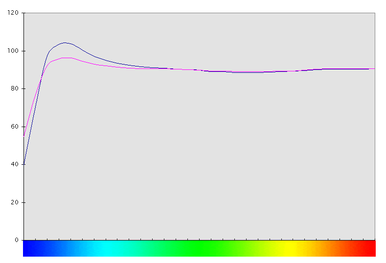

BTW, Epson enhanced matte discolors very quickly. Goes from the bright white to natural white in a very short amount of time. It is also slightly acidic. Most of us stay clear of EEM for anything that is important. WHen I was printing for money I would turn people away that insisted on my using EEM for their prints.
Here is a spectral plot of EEM after only about 15 days in a window, it takes about 2 months to reach this in a frame on the wall, and it continues to yellow from what is shown. Notice how the blue end is changing.
