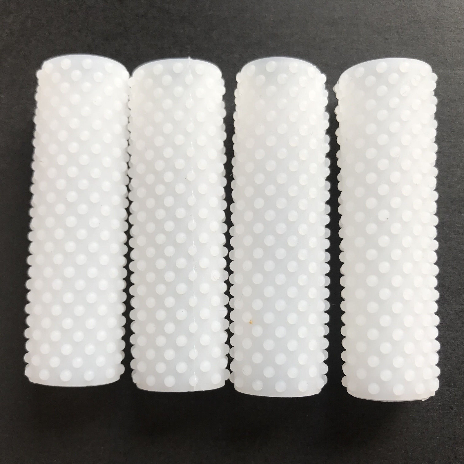

If the lab used a Noritsu film processor then this squeegie/roller could be the culprit. AFAIK it is similar to the squeegie/roller used in the Frontier & Noritsu printers.
