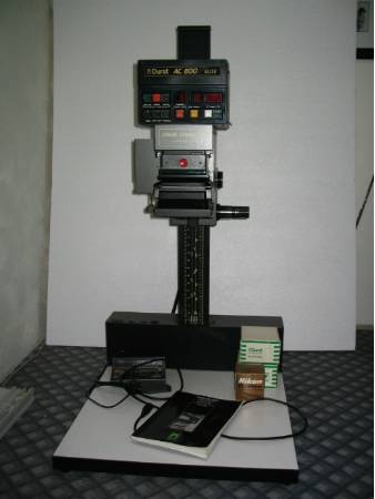

Hi,
I barely had time to research this enlarger. It looked so impressive and the auction was closing in 20 minutes I placed a low bid figuring I would never make reserve but it did! and I won it for $335US dollars! It looks to be worth far more than that and comes with 2 lenses. All of it is apparently in good condition. I've attached a screenshot of it, and will be driving out to pick up this bad boy on the weekend. Any insider info on this enlarger would be appreciated. It comes with a manual and is probably tricky to configure but with apug on my side I'm sure I can handle it. I am assuming it might have a built in color analyzer? Will I have any issues printing on VC paper? Also, I think it is autofocus? Thanks!

This looks like the closed loop (builtin densitometry), auto focus, med. Format durst. I sold one on ebay for 1,600 last year, but never used it. The specs on it looked impressive, but the two AC L1200 seemed to be preferred by those who did use them. (AC may be cool in a production environment but for personal use, I don't know) The one I sold cost a whopping 16k new with 3 lens boards, 5 neg holders, and 3 lenses (it may have also had two mixing chambers)
Some of the features (as I remember)
Reciprocity compensation on long exposures
exposure compensation for lamp output
Exposure memory
auto filter pack settings
auto density
Pre sets for common sizes
auto focus
Speaks both german and italian (no english)
35mm - 6x9 (which reminds me ours may have been an ac 960 elite)
I can tell you this the booklet sitting on the enlarger is not the * real Manual* , but the crap that is more promotional then instructive. The real manual may be tough to find and is required to utilize all the goodies if not the enlarger as a whole. It may also need a target neg to set the auto focus.
It has been out of production for at least 3-4 years. Beyond that i cant help you.

Congratulations with your new enlarger, Sean! Take a look at www.durst.it - if you've bought the AF version, it's supported until 2008. Just ask them for a manual!

Nice one Sean. Good price.
(hopefully) I currently own the same model. MrCallow covered everything pretty well, nothing much to add. Especially correct about the 'autofocus' - it's really more focus tracking with the rise and fall of the head. It will probably require configuring. It's quite straight forward, with a grain scope.
It does have a built in colour analyser. If you'd like a copy of the more extensive manual, I can lend you mine.
Dead Link Removed > Prod. Service shows this model is currently supported until 2008 :smile:

I have one as well and really enjoy it although it is not the auto focusing model. Parts are not to difficult to find for the carriers but you defintiely need the instructions if you are going to get the most mileage out of it.

Just got my AC800 configured for Fomapan 400 and MGIV some weeks ago and learned to push the right buttons in the dark. Well, usually you just need to push a single button to expose an agreeable print, it's almost too easy. This enlarger is a real gem of ergonomic design!
Also, figured out how to produce contact sheets and the machine works like a charm and actually makes the formerly so burdensome task of pulling contact sheets an enjoyable one. I had a backlog of more than hundred rolls of 35mm and I've now almost cleared that in a few nights.
