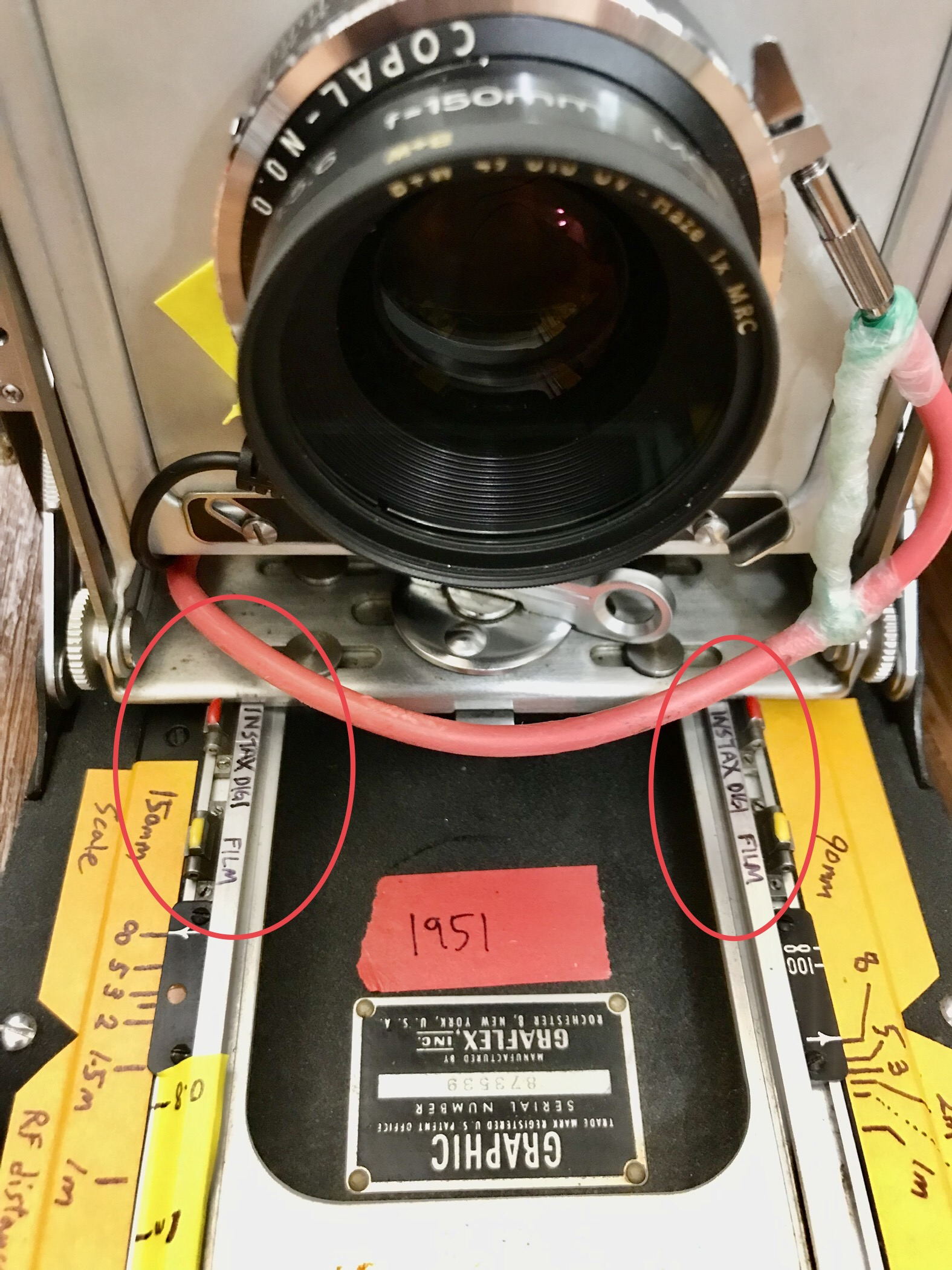

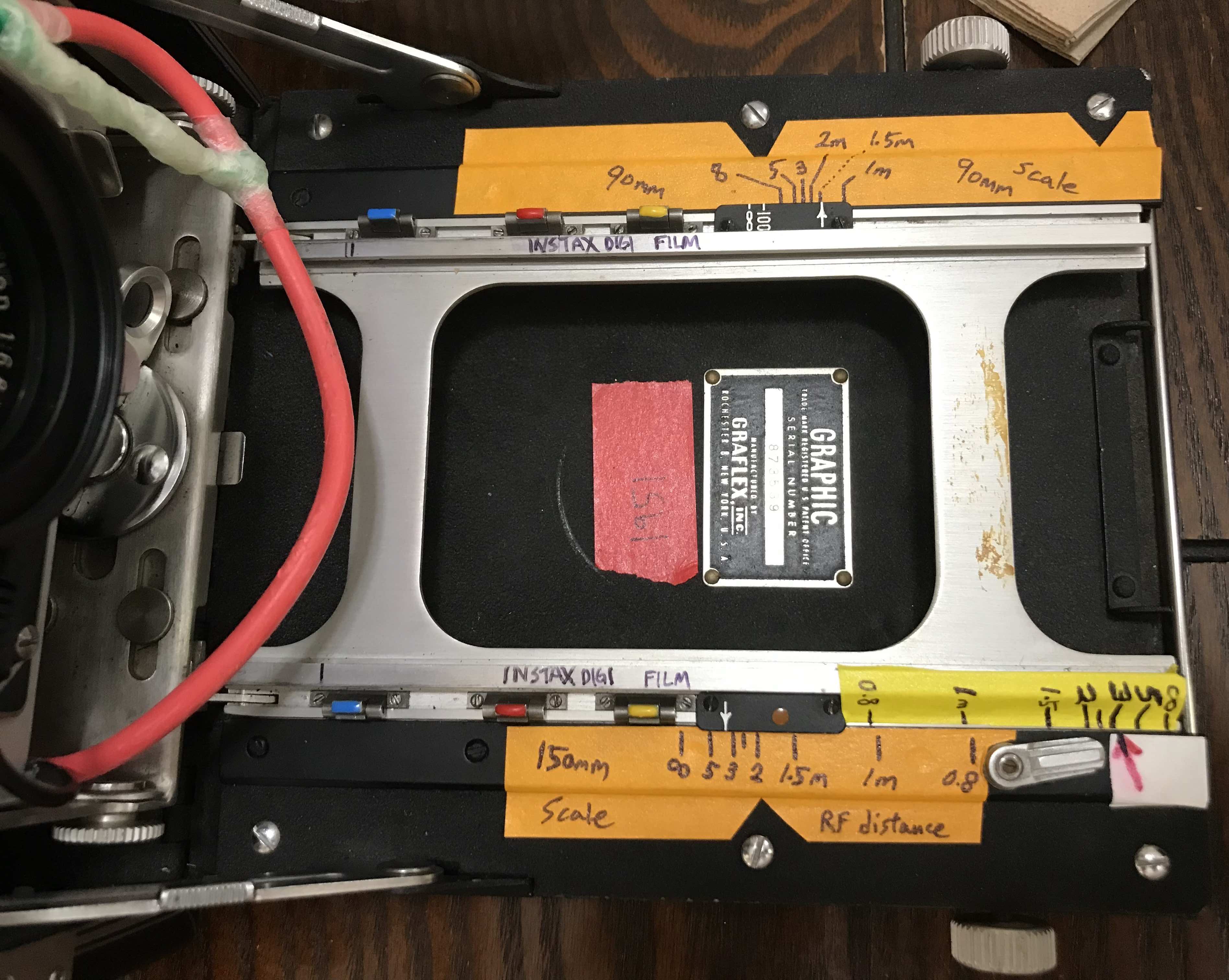

This is how I setup my Crown Graphic.
For 150mm lens:
Yellow stop is for normal film backs (front stop)
Red is for the Lomo instax back (front stop)
Blue is for the 4x5 plate to hasselblad V digital back (back stop)

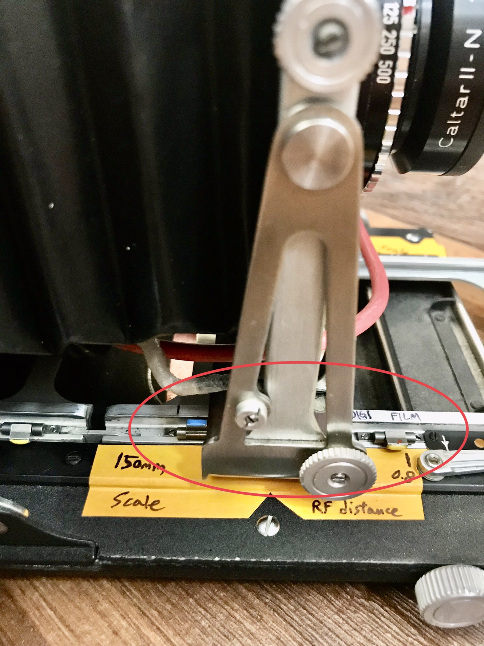

All three sets of the infinity stops are for 150mm lens, for different types of backs.
For regular film backs like 4x5 film holders I use the yellow stoppers but Lomo instax back needs to be back-focused so those red stoppers for it sits closer to the body. Yellow and red stoppers stop the front standard from the front like they should.
The blue ones need to be in-between red and yellow stoppers to work properly but there is no space available so I put them way back and use them to stop the front standard from behind. Notice when I use the blue ones the front standard is over the red stoppers.
This way I can use irregular backs with only the rangefinder and I don't carry the ground glass at all.

Well with the large format lens the instax pictures are much better quality compared to the ones you can make with the toys from Fuji.
People are very drawn to the whole setup and they are very impressed with the instant pictures so very good for parties and such.
The distance scales are for parallax correction and for 90mm lens focusing.
At close distance the parallax can be quite severe, so framing without ground glass is hard.
For that, I have installed Linhof universal finder and it needs the distance input.
I also setup infinity stops for 90mm Angulon but it is not rangefinder coupled.
I use it by locking the focus on certain distance on the 150mm scale, move to a point where it is in focus using the rangefinder, and adjust the focus using the 90mm scale. Wider DOF of 90mm lens allows generous focusing which is okay to my eyes.
