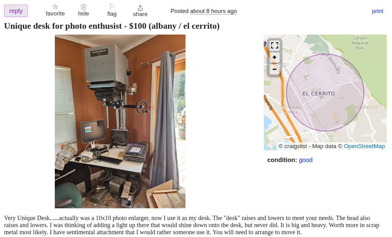

I have no affiliation with this. Someone posted about this on Reddit and I found the link:
If any of you lives around the SF Bay Area, perhaps you can save it? If it's in working order I imagine you can sell it to someone looking an enlarger.

It is a Durst, but I can't read the model number.

It looks like "Durst color laborator 184" to me. Don't those have external power supplies and such?
if this was in Seattle, I'd be there.

I live very close, but simply don't have room for yet another Durst enlarger, or the time to recondition another one. The colorhead itself appears to be missing. Apparently no neg carrier or lens either. These things are quite heavy; you need a serious truck and some help.

Durst L184 are harder to come by these days. Perhaps one of the best 8x10 enlargers on the used market, seeing as it is all manual (compared to the L1840). I'm not familiar with the light source on that one, but the enlarger accepts many different styles of light source.

Put a pancake style LED or cold light head on it, in lieu of the tall mirror box and a colorhead, and you might be able to get in a typical height room. But these almost instantly flip to horizontal usage, which would easily be accommodated by typical ceiling height.
The original colorhead was probably a CLS 301, which needs only two very common affordable ELH halogen reflector bulbs.
From the look of it, besides a head, refurbishing would probably require bellows replacement (about $200) and finding a neg carrier (anywhere from free to a thousand or more dollars), plus re-lubrication, and ideally a bit of easy rewiring for direct voltage. The cooling fan per se requires 240 voltage; the rest runs 110, provided there aren't additional issues. Lenses aren't necessarily expensive; you'd need lens rings too. It would make a deluxe 4x5 or 5x7 setup too, not just for 8x10. For MF, you'd need an inverted lens cone.
This isn't going into anyone's car unless the sections are broken down. Rent a truck if you don't have one. There are actually several L184's still in storage in this area. It's possible that a few of them will see a second life as the big labs begin to revive somewhat. The wild card at this point is the cost of b&w printing paper, with dreaded tariffs still to kick in. That could make enlarged optical mural printing awfully expensive.
