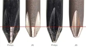

If the cameras are Japanese, you may need JIS screwdrivers. Moody tools (US) and Vessel (Japanese) are two brands I’ve seen recommended. I just bought a set from Moody, they seem to be quite nice, but I haven’t turned any screws withe them yet.

definitely JIS for all Japanese cameras. You'll just ruin the slots by using regular Phillips.
I was tempted to say "useless". But I looked up this:
https://www.dateelectronicsupplies.co.uk/news/the-jis-standard/4
And indeed, the phillips tips are much longer, from the marked reference plane. But I wrote in post #2 above:
the tip is often larger than the screw head in a non intuitive way
so I guess I must be selecting the next-higher size of Phillips tip (going for a tight fit), effectively using only the bottom 2/3 or so of the tip, mimicking the shorter JIS tip. I don't think I have yet stripped a cross head screw;
But definitely JIS screwdrivers is the professional option.
