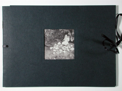

So I ended up making a 5x7" book of albumen prints with one of the Kolo albums, and I think it came out nicely. I drymounted one 6x6cm print on the cover and six 4x5" prints inside. I keep it in my camera bag in a 6x9" envelope.

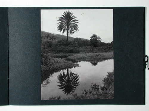

Back home, so here is the album, pages 1-5 of 8.

hi david:
really nice book!
its really nice to see photographs presented in book form.
i love how you included an image on the front cover. i keep wanting to do an image "on cover" but at the last minute shy away from it.

Thanks, John. The Kolo albums are set up for cover images. The cover sheet is actually twice as long as the other pages, so it folds in half, and there is a 6x6cm window, and you can mount a photograph on the inside of the fold so that it will show through the window. Then the closure ribbon goes through a hole near the fold on the right edge of the book to keep it all together.
How are you mounting your photographs in your books? These are drymounted, but I've been experimenting with starch mounting a bit.
