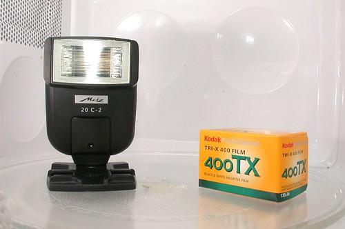

I had similar problems with my M2 & MP. I got the Leica SF 24D but with no bounce it is not that useful. Someone put me on to the Metz 20 C-2. It has a bounce head, lightweight and is not much bigger than a packet of cigarettes. It won't fry anyone's eyes but like you I use 800 + asa films and it is useful.
Metz 20 C-2

Excellent, thanks Leighgion. That's actually much smaller than it appeared when it was placed on a digi P&S. I think I may go for the Metz now.
Is that inside a microwave?
