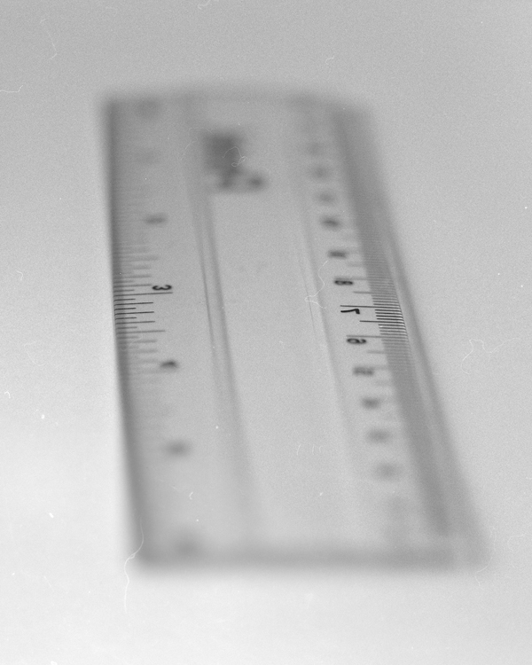

I've just done my own pretty crude test and you can see the results below. I focused on the number 3 and as you can see the actual sharp focus is just before the 3.
This explains why my negs have'nt been as sharp as I'd like but wouldnt this mean that something in front of the point of focus would have been sharp instead??
What is the best way forward now?
Thanks
Mike

Ian Grant
Aug 2, 2004
23,263
West Midland
Your test shows that the film is in a different plane to the screen, the screen needs moving back, away from the lens. Perhaps there should be a fresnel that would move the screen back, probably by the right amount. Other than that try making some shims out of card.
