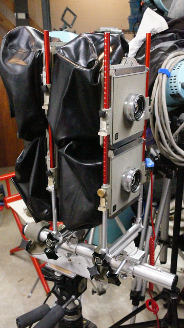

I decided to finish the 4x5 Sinar Norma TLR today. I found a couple of old boards with mickey mouse automation, I removed all of that. Then I cut large holes with my electric scroll saw, and finished with a good deal of hand filing. I just need to fill some holes with JB Weld. So now here two perfectly matching 240mm Schneider chrome Xenar f4.5 barrel lenses, should be great for portraiture. I exchanged the Black Binocular modern reflex magnifier on the back, with the original Norma Rubber Bellows, and the uber rare Norma Reflex Magnifier, which is quite small and I prefer it to modern Boxy Reflex Sinar.
So now I am ready to learn more about how this works. Testing looking through the camera went well, ready to go

Looks cool. But unless you use a roll film back, I don't see the advantage over a single one. And if you use one, I don't see the advantage over a 120 SLR.
Jan 16, 2010
1,685
Atlanta, GA
If the point is to use this like a LF TLR, I think the extraordinary amount of front rise might be a problem. Maybe I just don't understand what you're after.
Cholentpot
Oct 26, 2015
6,743
Sometimes its good to be weird for the sake of being weird.
I like.

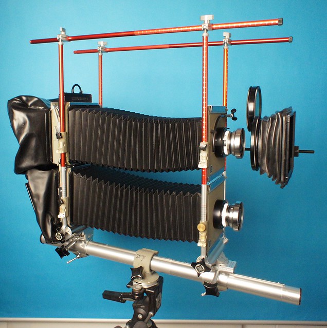

Here's the reverse view. I added a Norma Rubber Hood, Norma Long Bellows Rod, and Norma Filter Holder with 108mm yellow glass. So pretty much like it came right out of the Norma brochure. Was fun to put together. Some old things need fixing and I like working with my hands.
The advantage is that this is the fastest way to spontaneous 4x5 as in portraiture. It's not roll film. I know from experience that the the first exposure in a sitting is frequently the strongest one.

Very cool in an odd sort of way!
Thanks John. Time will tell how useful it will be. I can always take it back to spare parts :smile: Sinar says it works with all focal lengths. Interesting.

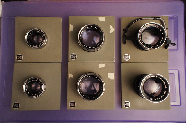

After searching around and configuring what I can right now, I have come up with three perfect identical lens pairs for the Fastest Norma twin lens camera. On the left, are absolutely identical Schneider 150mm f5.6 chrome Componons. In the middle, two nearly identical (will do ok) 240mm f4.5 Schneider chrome Xenars. The viewing lens only works wide open, the iris is not working. But OK for viewing. I still have to plug the mickey mouse automation holes with aluminum filler. And on the far right, a perfectly matching pair of forward mounted Schneider 240mm f5.6 chrome Symmars. The taking lens is a Sinar Symmar, and have direct operating mickey mouse aperture mechanism (least amount of automation aperture board). It will take several hours of metal cutting to buzz down the flange diameter, and enlarge the hole size in the top hat. Then all will fit and I will have three nice workable pairs for this camera

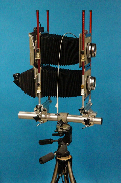

Matching 240mm Sinar Symmars in matching forward mounted lensboards. Clamping mechanism above adds rigidity, could use some short rods, across the top metric stock from McMaster Carr will do the job. Twin Sinar Norma Bag Bellows on back with Sinar Norma Monocular Viewers works great. More matched pairs are coming in, 150 180 210 300 chrome Componons, 250mm H5.8 Rodenstock Imagon barrel pair, So I will be well prepared for high speed 4x5 portraiture and tabletop stuff

Interesting concept compared to the Gowlandflex.
Yes in some ways similar but very adjustable as well "Construction Unit" design philosophy.
Film on top means you are not "shooting up" people's noses. I could see that happening.

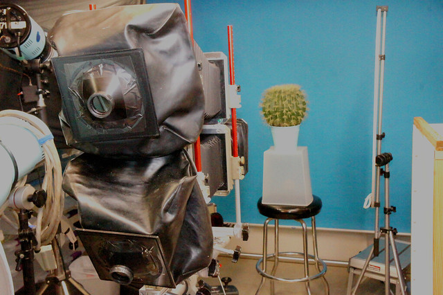

Today a matching pair of these 300mm Componons came in, I mounted them quickly into identical boards. The view through the top lens is from a higher viewpoint, that is what I want. I can get matching views as close as possible, something I think I csn get used to with more practice. I like this camera, it's so different from anything I have used. 300mm is 2X on 4x5 and is about as long as you can go I have read regarding the Gowlandflex. Sinar says this camera will take any focal length.
Fully Functioning Fastest Sinar Norma 2 by Nokton48, on Flickr
Here the fastest Norma is set up to provide identical views, with the identical 300mm Componons. Top and bottom views are similar, of course the top taking lens has a higher viewpoint, so I am shooting slightly slightly down versus the view lens. Desirable for high speed B&W portraiture
