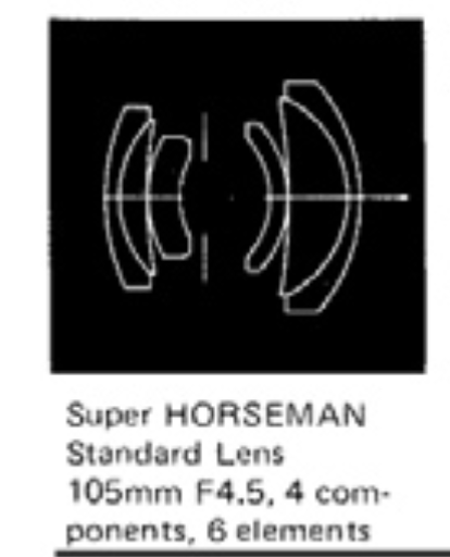

I use the f3.5 105mm mostly with the rangefinder, where I like the extra speed and lighter weight and I'm not using movements. That lens also folds up in the camera. . The f4.5 105mm is the largest lens in the Horseman Technical system. Its main advantage is that it is very sharp right up to the edge of the image circle. The image circle is a good match for the movements of the camera.
The f4.5 lens is noteworthy for its massive rear elements. Maybe Dan can comment on that design feature, for example how it looks like a backward version of the Nikon W 100/5.6 with similar image circle

Ic, I don't know where I got the idea that the 105/4.5 Horseman has six air-spaced elements. The picture you posted shows a sort of plasmat type. The ones I've seen offered are engraved 158 mm. That's the diameter of the circle covered.

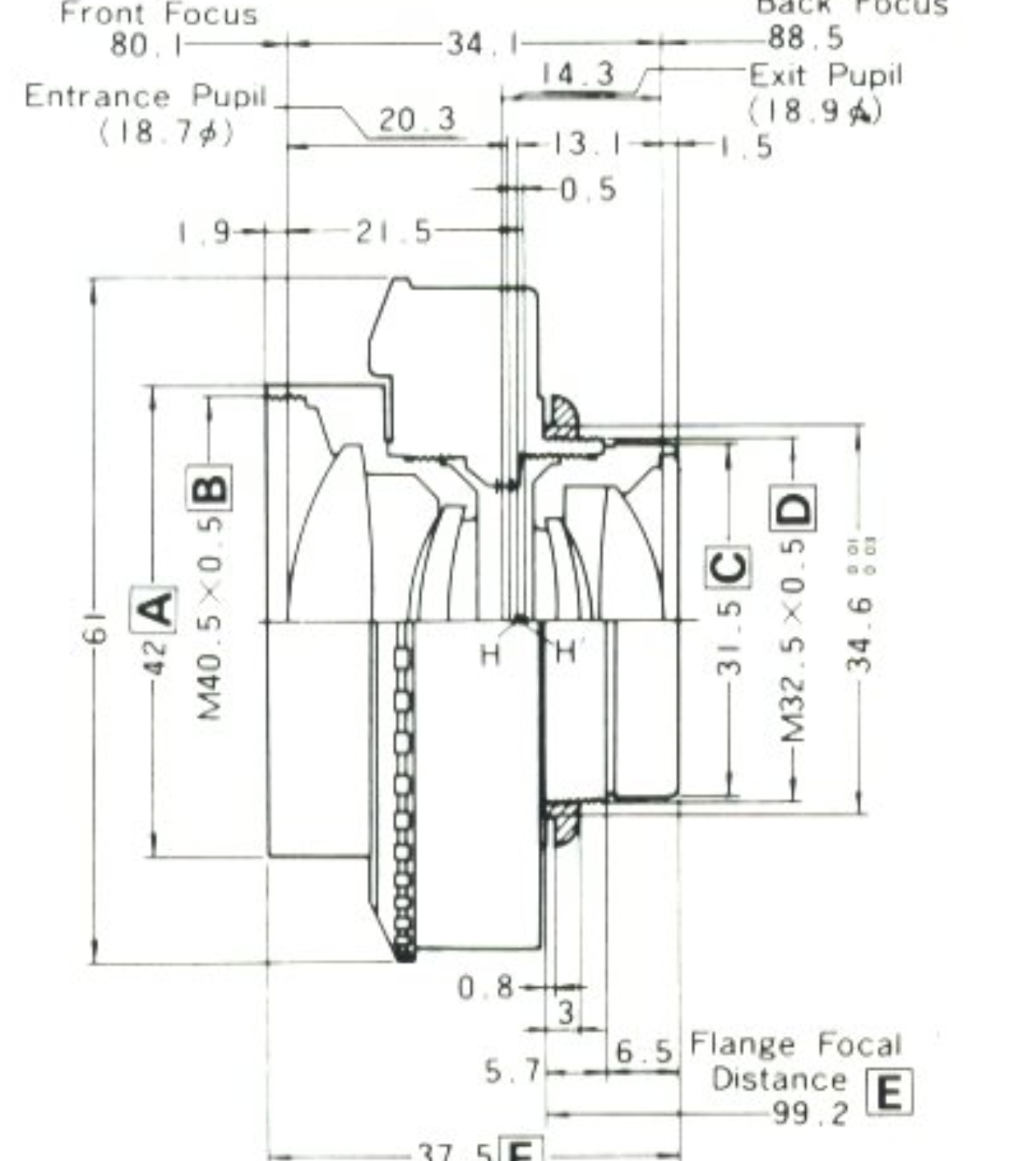

Horseman and Nikon have some similar lens. The minimal coverage Horseman f3.5 105 3/4 is like the Nikkor 105 3.5 3/4 and the wide-coverage Horseman f4.5 105 6/4 is like the Nikkor-W f5.6 100mm 6/4 but in reverse. In the Nikkor, the large component is in front, whereas the Horseman the large component is in the rear. (The diagram in post #11- above the large component is toward the film.)

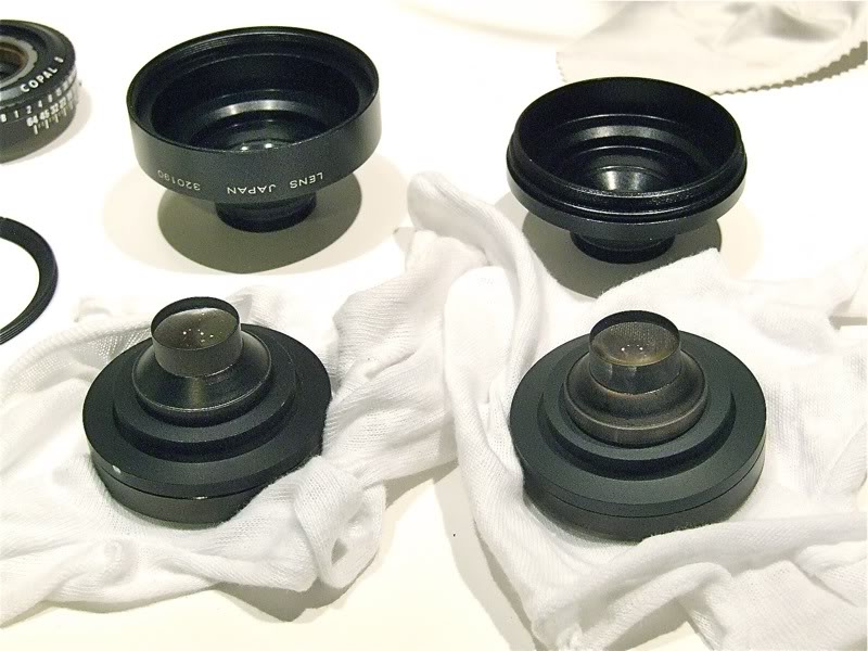

Yes, some Caltars and Topcors share identical glass in different housings. Important for Horseman users is the f5.6 90mm lens. In the Caltar housing, the lens won't fit on the camera. The Horseman branded housing allows for a protective ring to be removed, thus allowing the lens to be mounted through the limiting hole in the front standard.
The picture shows a lens group with separation from a Horseman branded lens being swapped with mint condition glass from a Caltar lens.

Ic, I understand that the Caltar's rear cell won't pass through the front standard's lens throat. I don't understand it can't be unscrewed from the shutter/board assembly and reattached through the rear of the camera. Will it not fit in the bellows?
I ask because I have a couple of w/a lenses that have to be mounted on my 2x3 Graphics that way and one w/a lens that fouls the bellows.
