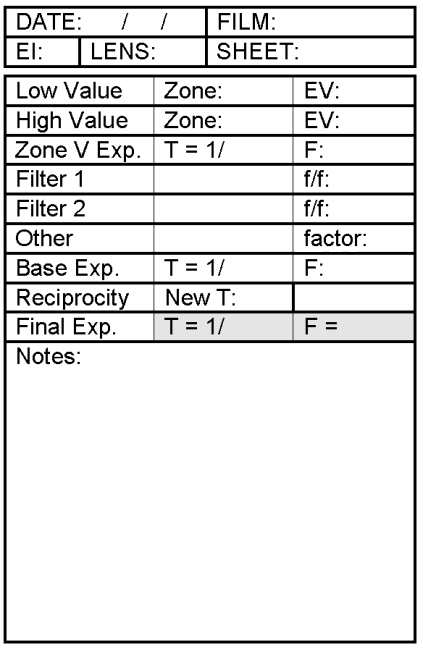

The ideal way of course is to use separate backs for N, N- and N+ development but, although I do have three backs, I don't do that... If I take more than one back, it's normally loaded with a different film. I only use N, N+1.5 and N-1.5 (didn't know Picker advocated that idea - I thought I invented it! :wink: ) as I use VC paper. Shots with ZIII to ZVII more than 6 stops or less than 3 stops get N+/- and others get N. I have a small pad of printed notes that I note this in (see attachment - 4 of these printed per A4 sheet of paper cut into 4 and stapled together in pads of 20) though I must confess, I rarely fill much of it in (except when I am using 4x5 which is a different kettle of lobster paté...).
A 12-shot reel of 120 will typically only have 3 or 4 subjects on it as I will move around a subject looking for different angles, or use a different lens - all probably shot in similar light. Thus usually all the shots have a similar brightness range. Worst case, I need to decide which are the ones I want to develop for, knowing that the others will probably still be printable at a higher or lower VC paper grade. So basically, I develop at what I think the most important shots on the film require and the rest will *usually* either fall in to place or close enough to it.
