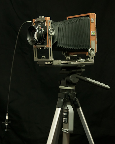

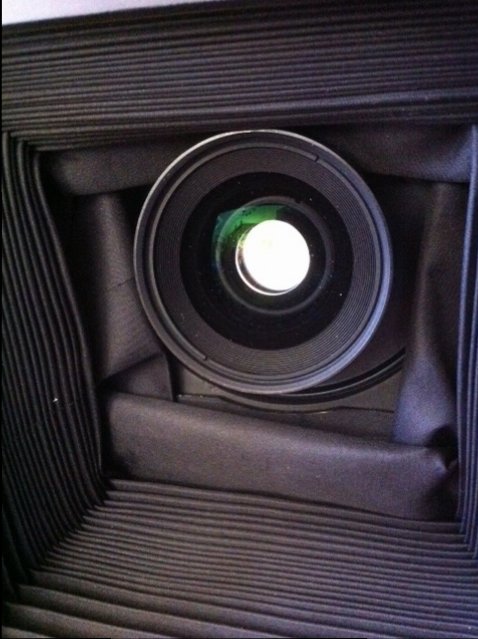

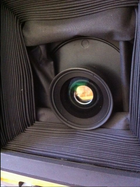

With a nikkor 65mm f4 sw (pictured) an inch of rise/fall is possible without forcing things to much. That's plenty on 6x9 format with that lens. You just have to pop the back off of the camera to make sure the bellows aren't obstructing the rear element. With my 90mm sw, the bellows restrict movements because the main bellows are bunched up too much for the huge rear element. I kept the leather shenhao bag bellows when I bought my chamonix since they fit both cameras (shenhao 45HZ and cham 45n-1, n-2). I you're going to be using short focal lengths all the time, I recommend spending the $125 for the bag bellows. I didn't wait long for my chamonix cameras since I bought both used on the large format photography forum.
the pics attached sideways but the idea is the same, appox. 1" of rise/ 1" of fall with the 65mm nikkor f4 focused at infinity.
ALSO, if you plan on doing any infrared work, the chamonix bellows I had on my 45n-1 weren't IR proof. I haven't tested the universal bellows on my 45n-2 yet. The shen hao bellows (regular and bag) were IR proof though.
