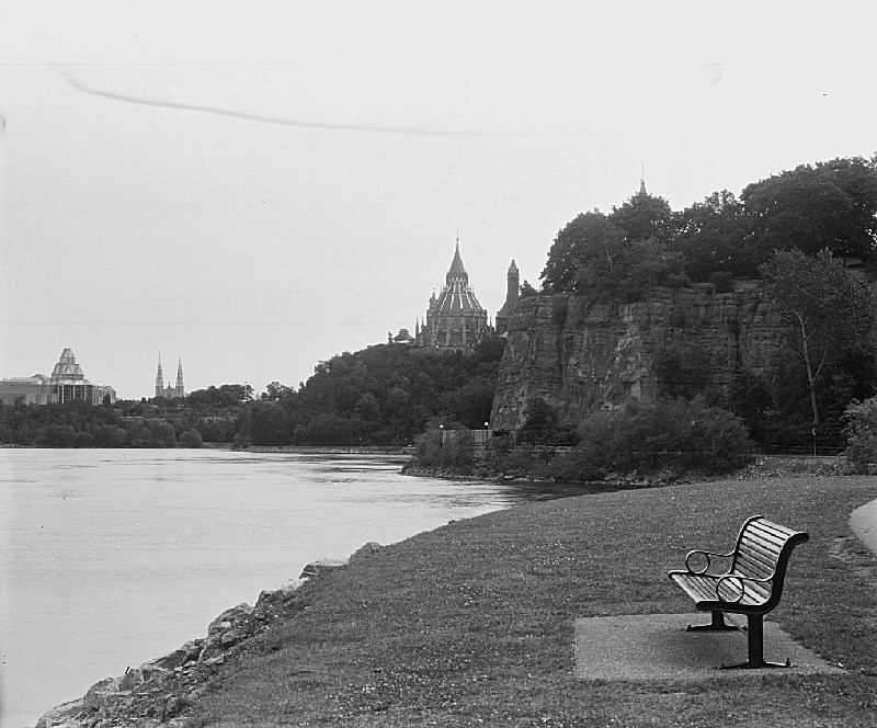

Here's a neg scan of the negative done with the barrel lens - please excuse my crappy scan.
It's got me puzzled. I had almost this exact same shadow last fall untill I blew out the bellows. It was fine after that and now it's back and I haven't used the camera for about 3-4 months.

Interesting. Definitely not a cable release or bellows impingement, and doesn't look like a light leak. If you didn't have exactly the same issue on several sheets of film I would guess it was a processing issue or the film being crimped.

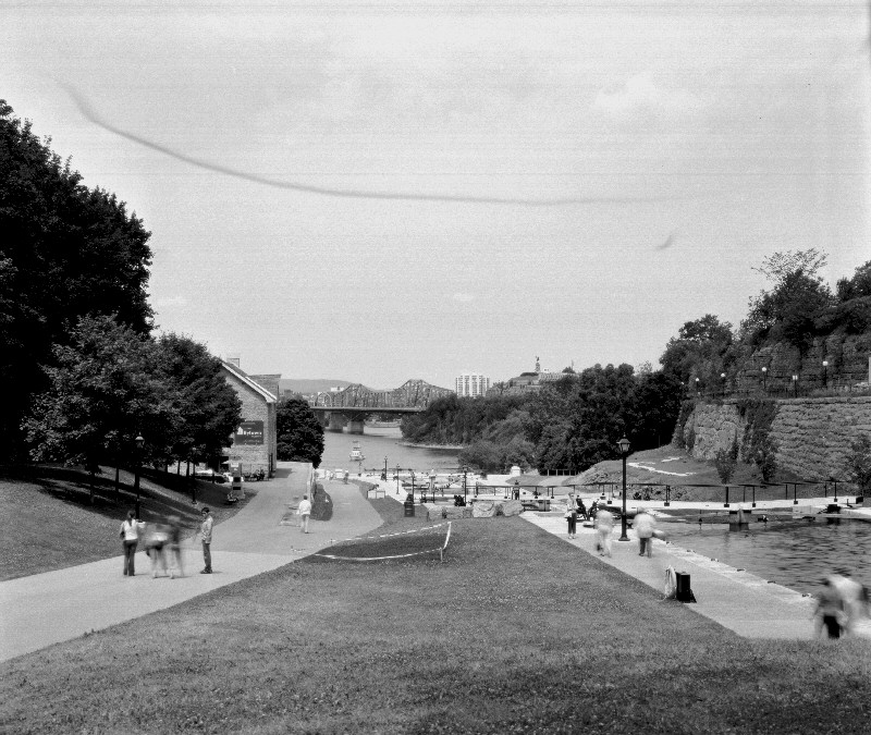

On Sunday past, I took two photos, the first one ( Parliament Hill Library building) is shown in my last post, the second one was at the Rideau Canal locks just east of Parliament Hill. The first photo was with the Goerz barrel lens and the #2 frame of one film holder. The second was with the Ilex lens and the #1 frame of a second film holder. The shadow is there in both but slightly lower in the second photo. Also, in the second picture I made sure I was standing in shade. I've had my camera apart again and can't see anything at all.
Anyway, thank you for all the suggestions, they are greatly appreciated. I guess I'll just have to dig in deeper and look more closely inside the camera.

noseoil said:
John, is this line exactly the same in each shot? In other words, is it happening in the camera in exactly the same spot each time? Is it always in the sky? It is an unusual effect, not one I've managed to do, yet....
Next question is, are you still using the aero roll film as in the past? Is it possible that it is a defect in the film, which is replicated and found due to your slicing of the film in whatever manner you are using? Just a thought. Please let us know when you get it sorted out. One for the weird file. tim
Hi Tim,
Yup, definitely one for the weird file :smile:. I've gone back thru' my negs and logs and the one and only constant is the camera body. All the other stuff I have has had a picture with this shadow. That includes two tripods, three film holders, two lenses, the camera back in two orientations etc. The only thing left is an errant thread in the bellows - it has to be !!! After I blew them out last time, the shadow disappeared, so I'm going to do this again and see what I can see. I'm also going to stretch them out and gently run a damp cloth across every single pleat just to make sure. I also checked the only other constant (film and cutter) and I'm going to go out on a limb and say that I don't "see" anything wrong there.
Attached is the second picture taken on Sunday. It was a different lens, a different holder and a different bellows extension. The shadow is in almost the same place.
cheers and yes, I'll post when I've found the little devil that's causing this assault on my sense of humour :smile:.

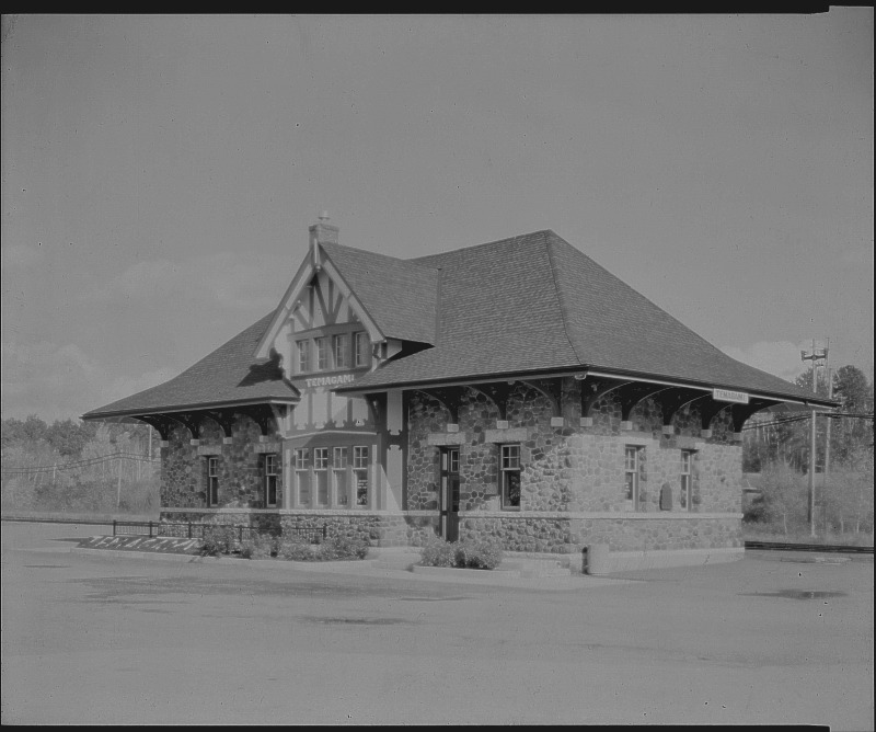

Update ...
So, before heading out on holidays to Northern Ontario earlier this month, I took my camera apart and not only blew it out with compressed air, but also wiped the inside of the bellows with a damp rag to make sure that some mischievious spider wasn't hiding away in there. Over the holidays I exposed my three filmholders twice each for a total of 12 shots and I didn't get a single imperfection in any negative!
I have to assume that the problem was a spider web as that is the only type of thread that would rise from the bottom of the camera bellows.
Last year, one of the "shadowed" photos was the Temagami train station. I shot it again this year and ... attached is a negative scan of the Temagami train station. This was scanned thru' the mylar protective sleeve complete with dust etc., so it's not a great picture, but I can hardly wait for a printing session as I'd like to frame and hang this one for my Dad who taught school in Temagami in the 1950's.
As an aside, this is PlusXAero (again), but I have the speed now rated down to iso10 and I am developing in D-D23 for 5 minutes in "A" and 4 minutes in a "B" bath of Borax
