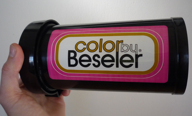

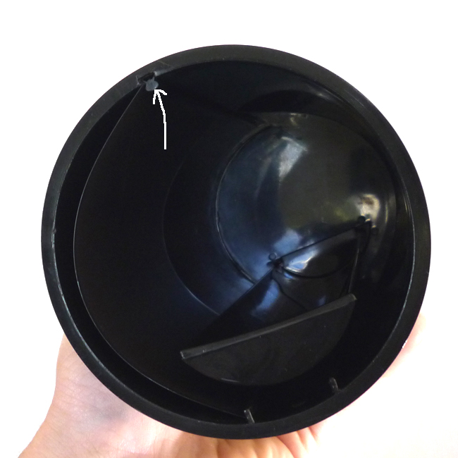

    I can't find any info on the web about this. Usually searches result in unicolor drums. I've got 8x10 beseler drums. I've read about separating the sheets lengthwise but I have the slide-in rib for that. It's when I develop two or four sheets that one sheet can slide down and overlap the other, resulting in 1 portion of a neg not getting the chemicals. What have you guys done to overcome this? Is there a trick gadget that can attach to the slide-in rib?

    Well, I have Jo's old Beseler base, and the eraser works really well on the Unicolor drums that came with it.
    I also have a Chromega and a Beseler color drum Both have a round rail that separates the 4x5 or 5x7 sheets, and when doing more than two 4x5 sheets you put two side by side, correct? Both Chromega and Beseler had a little butterfly looking thing that would slide onto the round rail after you inserted two sheets, one on either side of the round rail, all the way to the bottom of the tank. Then the 'butterfly' would slide in until it touched the side of the 4x5 sheets, and then the remaining two sheets before you close up the tank.
    I would try to find a piece of fairly stiff, but flexible (without breaking when you bend it) plastic tubing with an inner diameter about the same size as the outer diameter of the round rail. I would then cut a small piece off, about a 1/8inch or so, and cut off about 1/4 of the circumference of the material, so that you could use the rest to clip onto the round rail.
    That's all I can think of. Don't know if the eraser will work on these. The erasers Jo gave me for the Unicolor drums work, because those drums have a V-shaped rail instead of a round, and it's easier to 'grip' than the round.
    - Thomas

    Jo, Thomas, thanks for your replies. I managed to make a couple tabs out of some 1/8 plastic. I cut and filed them to the shape/radius of the drum and cut a notch (with a tiny round file) to fit snuggly onto the rib. I just souped 4 sheets of classic pan 400 and they turned out quite nice.

    Going to resurrect this thread since I have some questions... I got one of these recently and am looking forward to using it.
    1) Mine did not come that slide-in rib. Has anyone come up with a suitable replacement for it?
    2) How much chemistry does this take? Does 200 mL sound about right? And how much am I supposed to cut development time when rotary processing?

    w/o the rib, you're screwed. Hell, even with the rib, I was screwed till I sold the drums and got jobo expert drums. Now life is good.
