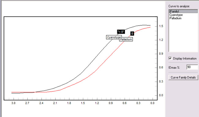

Attached is an image file showing a cyanotype compared to a palladium curve. This curve should give you some idea of what to expect in printing cyanotype, especially as that regards the toe and the shoulder of the curve.

RalphLambrecht said:
Sandy
Thanks for sharing. What software did you use to do this. Phil Davis'?
Hi Ralph,
Yes, I used Davis' Winplotter program for the plot. The step wedge prints were made on COT 320 and the densities read with an X-Rite 810. I read the reflection density of the cyanotype with Red channel, and that of the palladium print with Blue channel, which I find gives a better indication of the actual depth of shadow density as seen by the eye than the Visual mode. 100% of Dmax when read this was was about 1.5 for both processes.
Sandy

Thanks Sandy
Thats exactly what I wanted to know.
