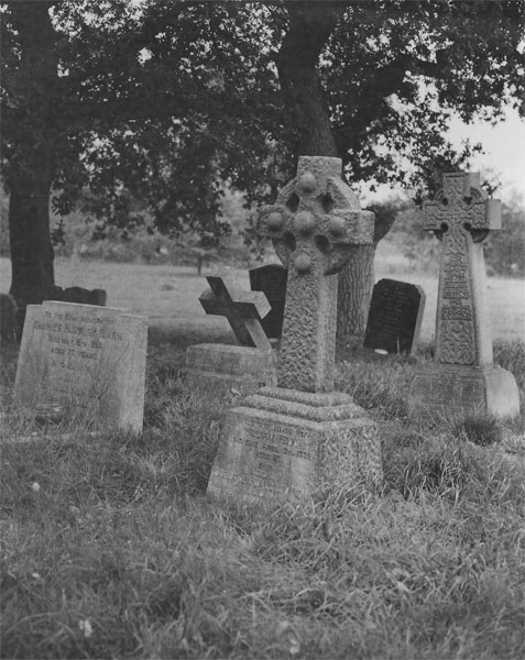

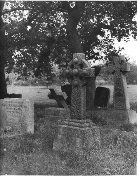

A month or so ago I posted an image of a graveyard scene to the gallery *see (there was a url link here which no longer exists) if you are interested but it's not essential to the discussion). Among the feedback was a comment from Donald regarding the lack of local contrast in the print and a suggestion to print at a harder grade. However the problem was identified as a low contrast neg. At Donald's suggestion I gave the neg 5 minutes in selenium toner (1-4) and then reprinted at a one grade harder. The images are attached, the left one being the original and the right after Se treatment.
I have cropped the latter print on the enlarger (another comment was that the scene was too 'busy') and have scanned the same portion from the original for comparison.
I feel that there is a difference between the two and that the second does have more 'presence' but welcome your comments.
Again many thanks for Doanld for his advice - the consultancy fee is in the ether :smile:
I will shortly post the new version to the gallery.
Cheers CJB

Thanks for posting this example. I think that allowing others to see the results of these steps is important to their choices.
I do like the results of the steps that you have taken.
David A. Goldfarb
Sep 7, 2002
19,981
Honolulu, HI
The intensified neg will probably make a better print ultimately, but I think both prints are just too dark.
Selenium intensification of the neg pushes up the highlights, but if you expose the print so that the highlights are the same as they were with the unintensified neg, and then on top of that print at a higher grade, the effect will be to push the shadows down, and they'll block up, as they seem to be doing here (if the scan is a good representation of the print).
I'd say start by printing at the original grade, expose for a little more luminosity in the highlights--judging from the dry print, so you're not tricked by drydown--and then adjust the paper grade if you aren't getting enough shadow density.
What was the original grade of paper and what was the harder grade?
I agree. Perhaps it is just the scan, but the result is still too muddy. Judging by the original scan, there seems to be plenty of information in the neg. It might have been better printed differently to begin with and may have made a fine print without the toning. Not being disrespectful of your printing, but the original as well as several in your gallery seem to be kind of flat in the middle and fall-off in the corners. Is there a chance your enlarger's condenser is set incorrectly? It looks as if they are printing hot in the middle. If not, perhaps kicking up a grade, lightening the print a bit and burning the corners to balance the print will help?
B
Tom Stanworth
Sep 4, 2003
2,022
B
Me too. I would in this print, flash the paper or fog for tone in the sky and print the remainder lighter. This will ensure greater luminosity throughout as well as tone in the sky, worsened by merely printing with lesser exposure.
I have a similar situation I believe with some really old negatives I happened to run across doing some closet clean out.
After 20 years of being away from the darkroom, I feel like I am starting all over again!!
I went from grade 3 to grade 4. I was last in a darkroom 25 years ago but never really got the hang of it, the results I found make me cringe !
One day I hope to approach mediocrity :smile:

Getting a print that exhibits presence is a matter of attaining optimal local contrast. Printing is a dance to develop local contrast while not exceeding the overall contrast characteristics of the printing materials.
If one can print at higher overall contrast, then local contrast will benefit. If we need to reduce overall contrast, then local contrast will diminish.

I agree with Msr.s Goldfarb, Schwab and company. The second print is blocked up in both the shadows and the highlights. Too contrasty. I'd start over with a normal Grade 2 print, and work from there. I used to favor really contrasty prints, but then I learned better when I realized how much time I was spending burning in blown-out highlights. I'm not saying to go down this road yet, because it is a very expensive road to go down right now with the Dollar<->UK Pound exchange rate being what it is, but think about getting a StopClock Pro timer from RH Designs, with the Analyzer. The analyzer is a mini densitometer and will help you determine proper paper grade to use when printing because it can show you the range of tones on your negative.
