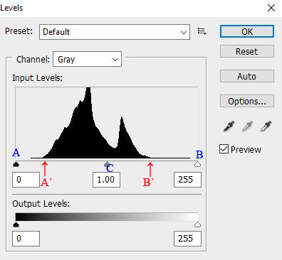

    This is a histogram of a B&W image (color will be similar for RGB channel). A- 0 is pure black, B- 255 is pure white, C- gamma or mid tone adjustment. Move C toward A and the image lightens, move C toward B and the image darkens.
    A' is the point where the usable information in the negative/photo begins; B' is the point highlight information ends. These are called the Black and White points. Before or after the rise in the histogram is no usable image detail, beyond the start of the rise or before the end of the rise clips usable information from the negative. Setting the B&W points to A', B' with the output levels as shown expands the usable information and makes tone adjustment easier.
  13. OP
    M-88
    M-88 Member
    Ads Enabled
    Messages:
    260
    Joined:
    May 2, 2018
    Location:
    Georgia
    Shooter:
    I usually do that trick to reduce white fogging on telephoto shots with my not so perfect lens on digital camera.
