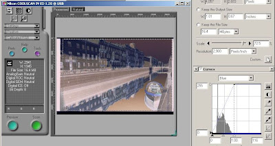

Hi
I've tried following Pellicle's advice, and scanned color negs as positives. My experience with my Epson 4990 is that colors are truer and more saturated, but grain is worse.
glad you got some benefit from it. With respect to the noise, I've found that one needs to set the clipping points for red green and blue carefully. Much of what is called grain is channel noise (sorta like the stuff on the TV when you're off in no channel). As in my blog post.
this image shows how I've adjusted for the blue channel.
Then in photoshop (or your prefered editor) the use of some curves is also pretty needed to get the tones looking right. I find that adjusting them together is simplest first then tweaking each gradually later. I hold down the dark areas for a little bit and make the high areas taper off

Thanks, Sandy, Pellicle. What you say certainly makes sense. I'll have to try this again, and make double sure that no clipping is going on -- pretty sure there isn't, but I'll check anyway.
I've also noticed that, after inverting, the color is almost totally washed out, now that I think about it. Seems like getting rid of the orange mask also ends up getting rid of most of the color also. But I countered this by punching up saturation -- a lot. Anyway, I'll give this another shot, and let y'all know of my results.
thats why you need to then apply the curves ... after that try playing with the Hue for yellow first (not the saturation but the hue, its the top of the 3 sliders in the hue control in PS). It may need moving towards the red or the green depending. Often blue or Cyan needs tweaking too ... sometimes red needs shifting away from or towards yellow too

Hi
