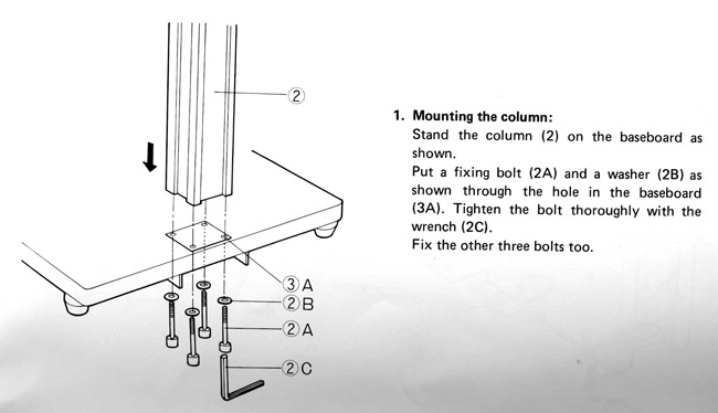

    Does anyone know what size bolts are used to fasten the the Saunders LPL4550xlg enlarger column to the baseboard ?

    Since I have one I thought it would be easy to look up in the owner's manual, but it only describes them as "fixing bolts" without giving the size of the bolts. Their long with an allen wrench head, without dismantling mine, I want to say maybe 1/4 inch thread and they require a washer too. Sorry I can't be of more help, but I would just try a few sizes and see.
    Here's a page from the manual.
    Chuck

    Ok. Now I'm not an expert on this stuff, so take this with a grain of salt. I'm pretty sure that it's a 55mm long hex head cap screw (Class 8.8 DIN933) with an M8 body diameter (8mm measured outside thread diameter) and a thread pitch of 0.8 threads per mm. Hope this is right and helps.
