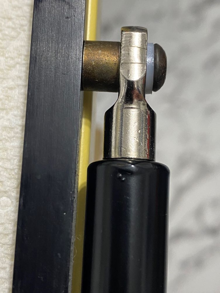

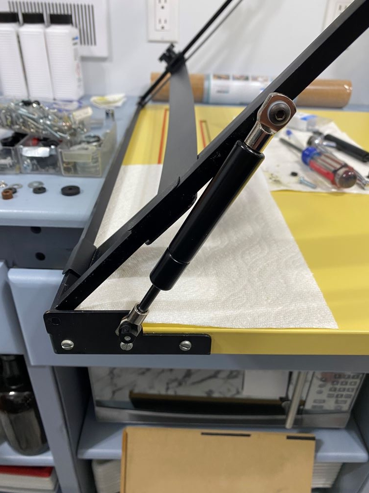

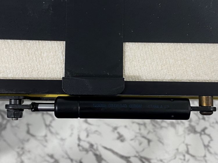

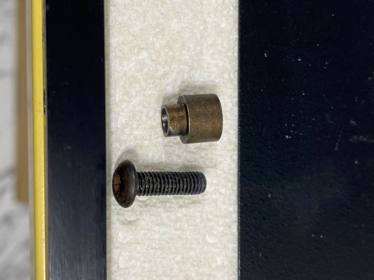

Sharing my fix with the group...

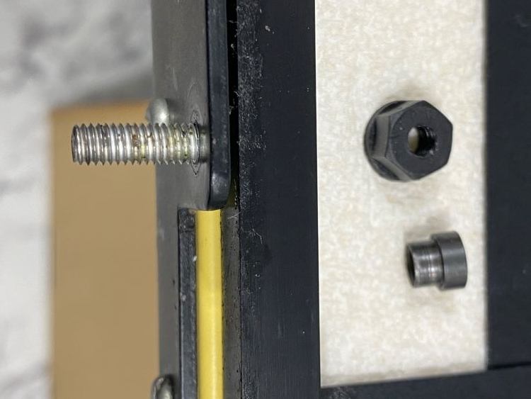

The original Oil Filled Spring developed a leak of a yellow oil and would no longer hold up the frame.

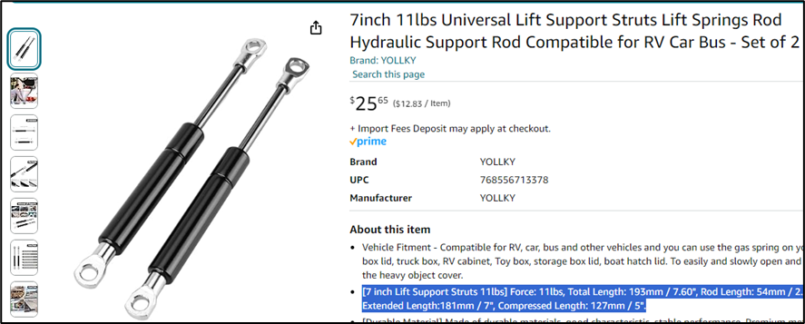

I ordered a Gas Spring from Am@zon Canada (see below for details)

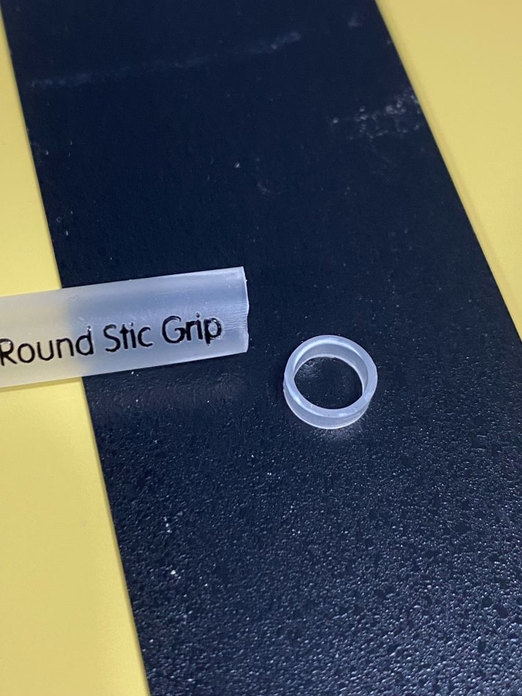

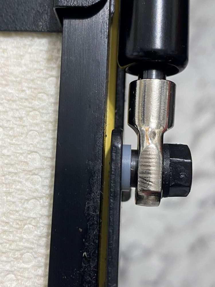

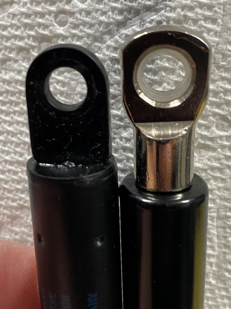

The brackets on either end of the gas spring have mounting holes that are larger than the original, so I DIY'd a bushing to take up the slack.

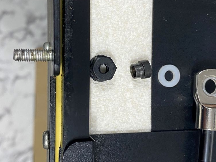

I reused all the original hardware, however I needed to add 1 #10 Nylon Washer on the moving end and 1 on the fixed end.
Photo 1: Original Oil Spring in place
Photo 2: Moving end original hardware
Photo 3: Fixed end original hardware
Photo 4: Comparison of original and new Springs (shows new spring with DIY bushing in place)
Photo 5: DIY bushing for new Gas Spring
Photo 6: Additional Nylon washer added to original hardware
Photo 7: Moving end in place with additional washer
Photo 8: Fixed end in place with additional washer
Photo 9: New Gas Spring holding frame in place. Holds in place from vertical to about 35 degrees
All the best
Todd
1-OEM Piston.jpg 2-Moving End OEM Hardware.jpg 3-Fixed End OEM Hardware.jpg 4-New Gas Spring with DIY Bushing in place Comparison.jpg 5-DIY Bushing for new Gas Spring.jpg 6-Additional Nylon Washer to Moving End.jpg 7-Moving End Installed with Additional Washer.jpg 8-Fixed End Installed with Additional Washer.jpg 9-New Gas Spring Holding Frame in Place.jpg
Replacement Gas Spring from Am@zon Canada:
$25.65 for 2 unit package
[7 inch Lift Support Struts 11lbs] Force: 11lbs,
Total Length: 193mm / 7.60", Rod Length: 54mm / 2.12",
Extended Length:181mm / 7", Compressed Length: 127mm / 5".
#10 Nylon Washer from Home Depot:
Paulin #10 Nylon Flat Washers x 2 pieces $0.22 each.
