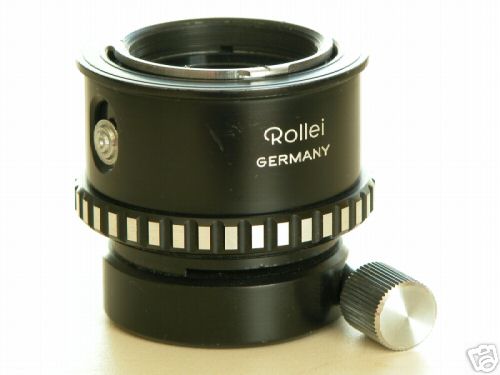

Along a similar vein, I just bought a Rollei Microscope Adapter on eBay (Bay 1). Has anyone used one of these? I assume that I focus to infinity, but how do I choose exposure settings?
