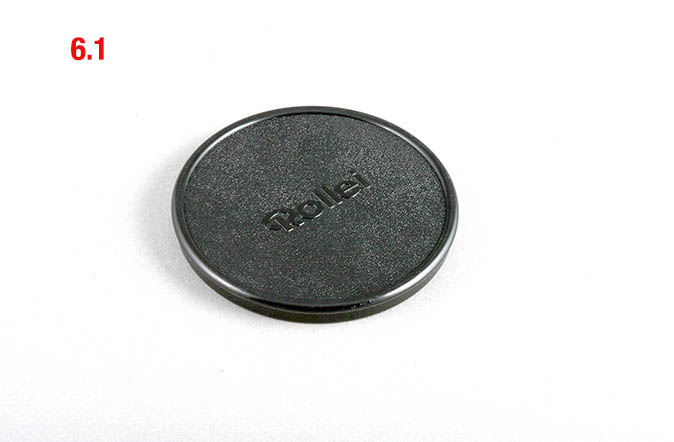

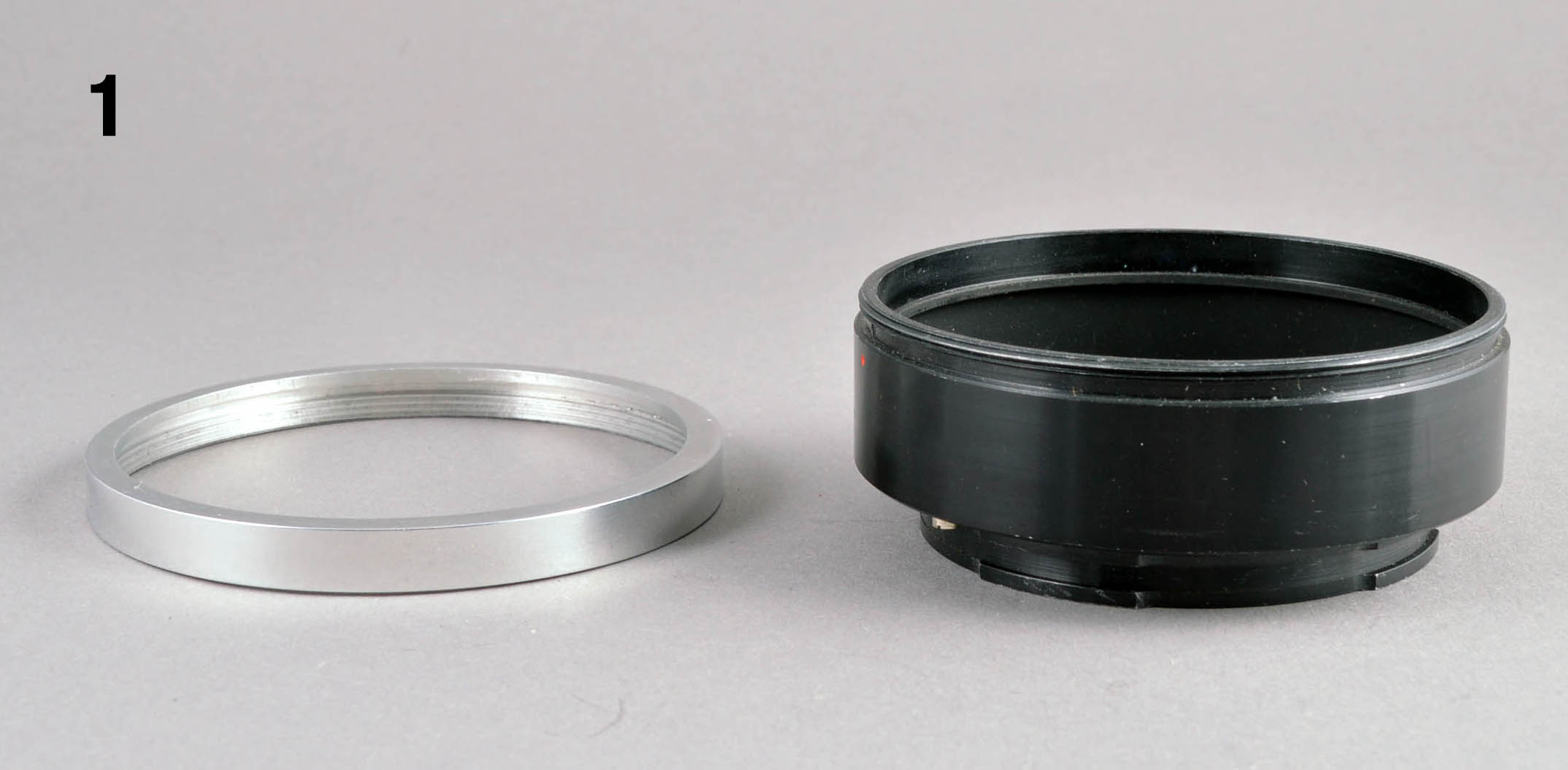

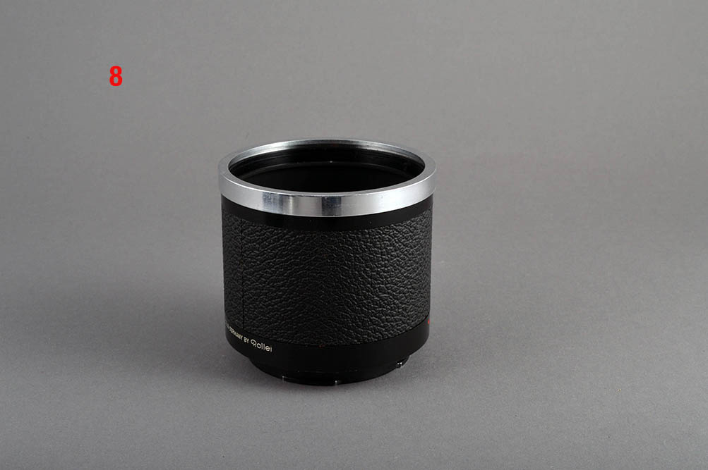

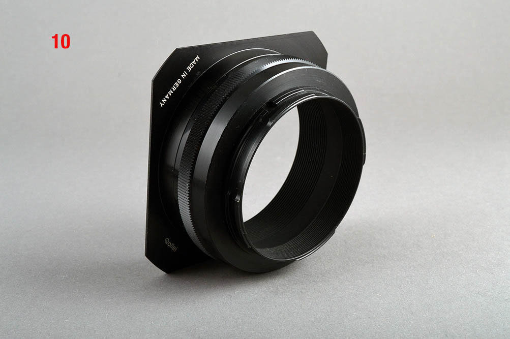

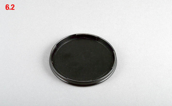

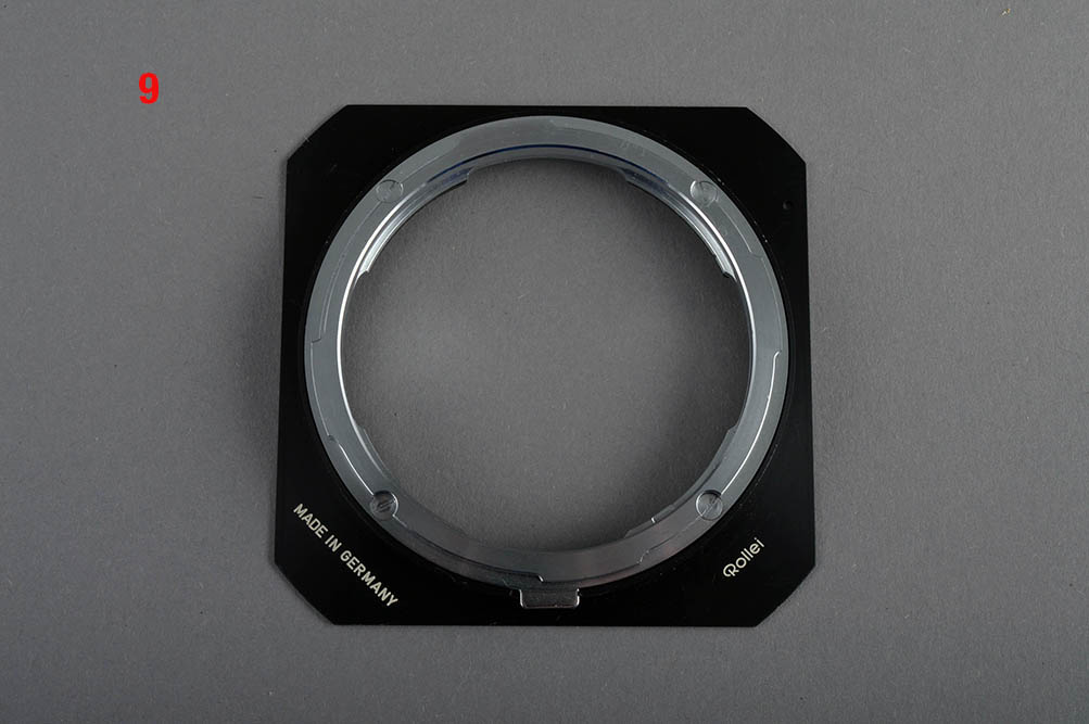

I recently bought a long desired Rolleiflex SL66 and it came with a bunch of accessories that I am having trouble identifying.
I am assuming they are for some kind of Macro or Copy work, but I would like to ask for help in identifying them because the camera came with one lens and a box of these that I don't know what they are.
So Here are some of the pictures. Please let me know what they are.

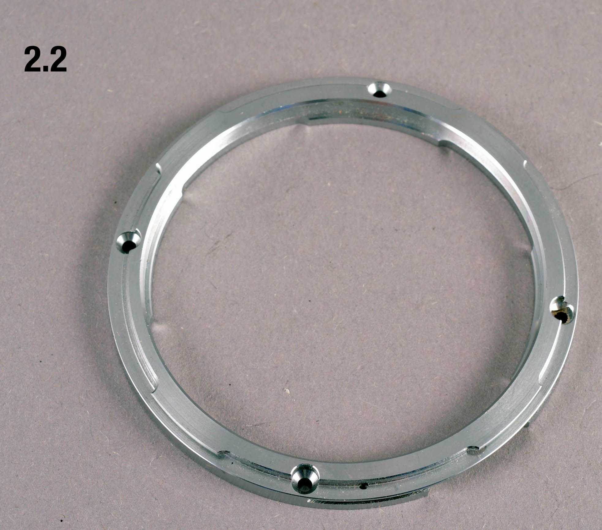

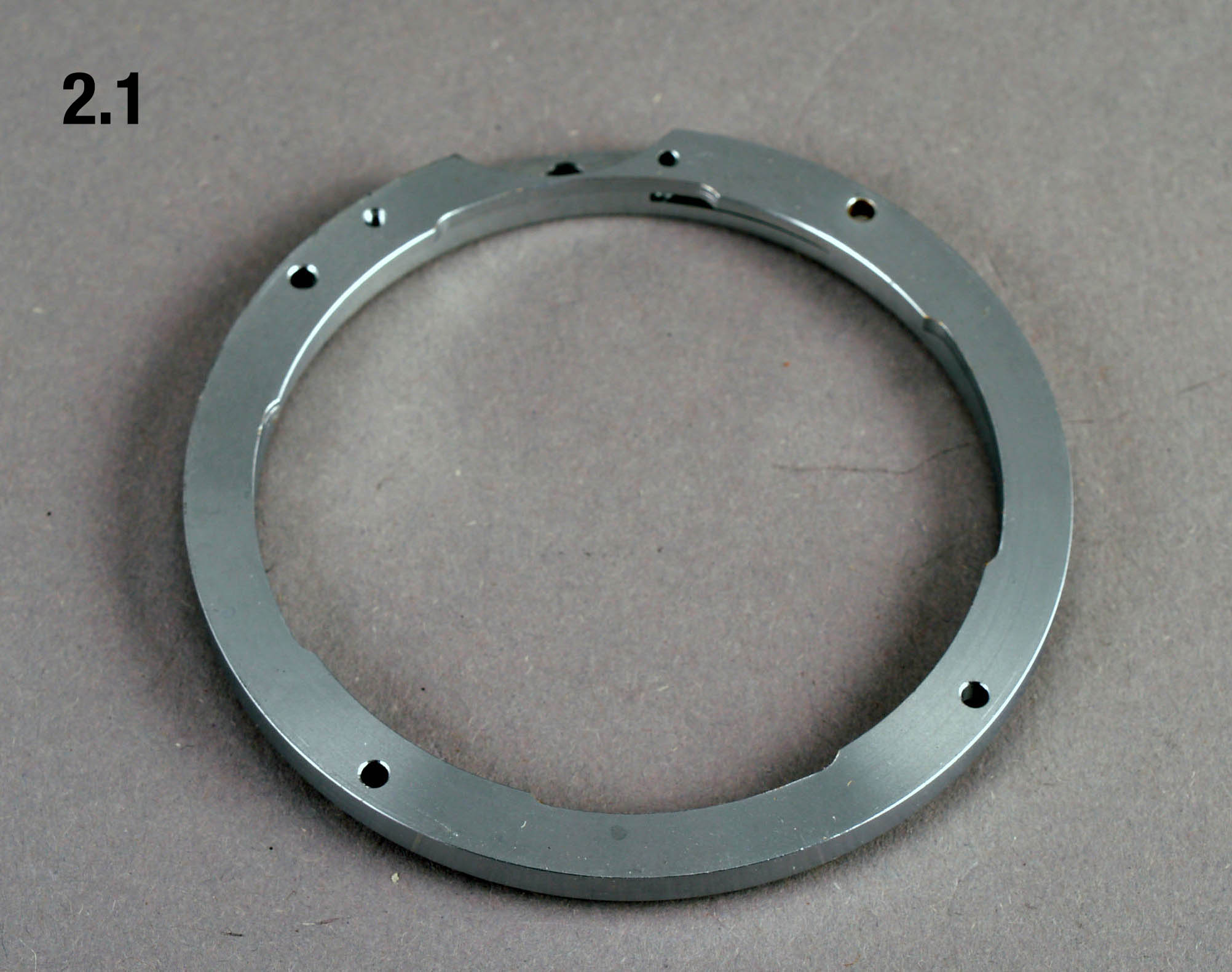

Pictures 2.1 and 2.2 are of the same bayonet mount that was wrapped in a piece of brown paper that had the following numbers written on: 96.841.00.0
Thanks in advance
Milo

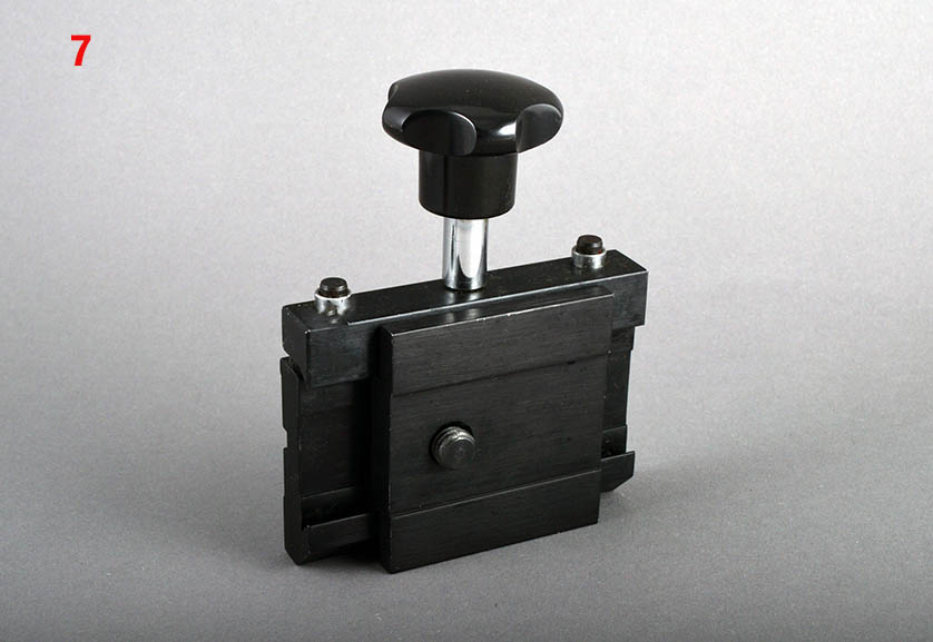

#7 is a QR tripod mount. Looks like an Arca-Swiss which is pretty common.
A number look like close-up accessories/extension tubes. probably be easier to work out playing
with them than with pictures but someone here is sure to identify them.

One of the most useful things that often come with these cameras is missing, the mount for other third party lenses, such as large format lenses or Imagon, although if you wanted one it looks like it could be improvised from some of your bits that have a bayonet fitting like a lens bayonet. I have a bag of bits similar to some of yours, some of which I can't identify either.

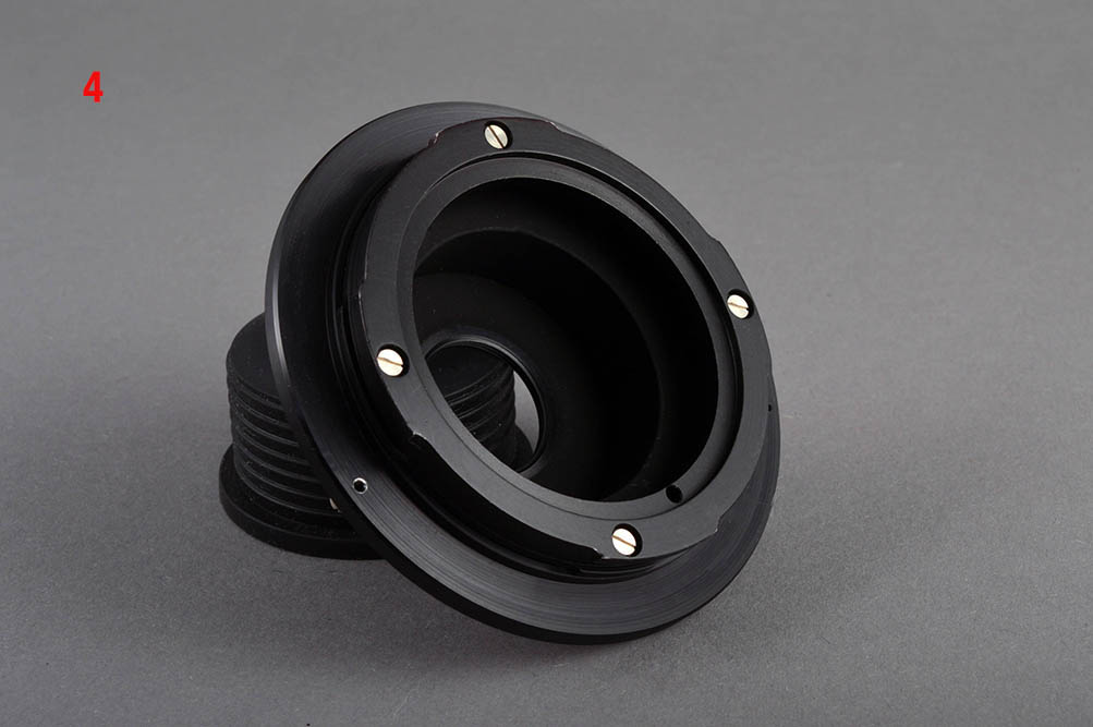

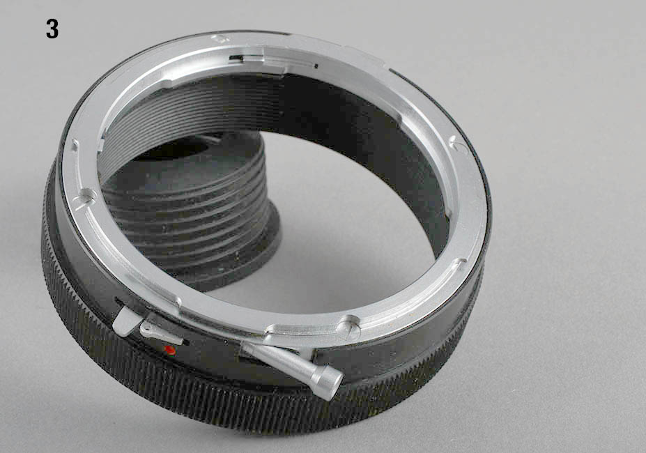

R3 looks like part of a bellows lens attachment, with a cable release to allow auto aperture closing for a lens attached to a mount separate from the camera.
As the previous poster says, R7 is a tripod mounting clamp with a universal Arca-type plate. I modified an off-the-shelf plate to fit the camera snugly so I can use a similar clamp. I have found it more stable than the Rollei tripod mount that fits into the wedge arrangement on the camera base. I can post a photo if you're interested.

9 and 10 look like parts of a bellow attachment. I can´t help with the rest. It all looks rather exotic to me, definitely not your normal extension tubes. Probably to mount the camera to microscopes, telescopes or to use 3rd party lenses. As John said, the book by L. A. Mannheim is the definitive guide to this camera. I can highly recommend it as well.
