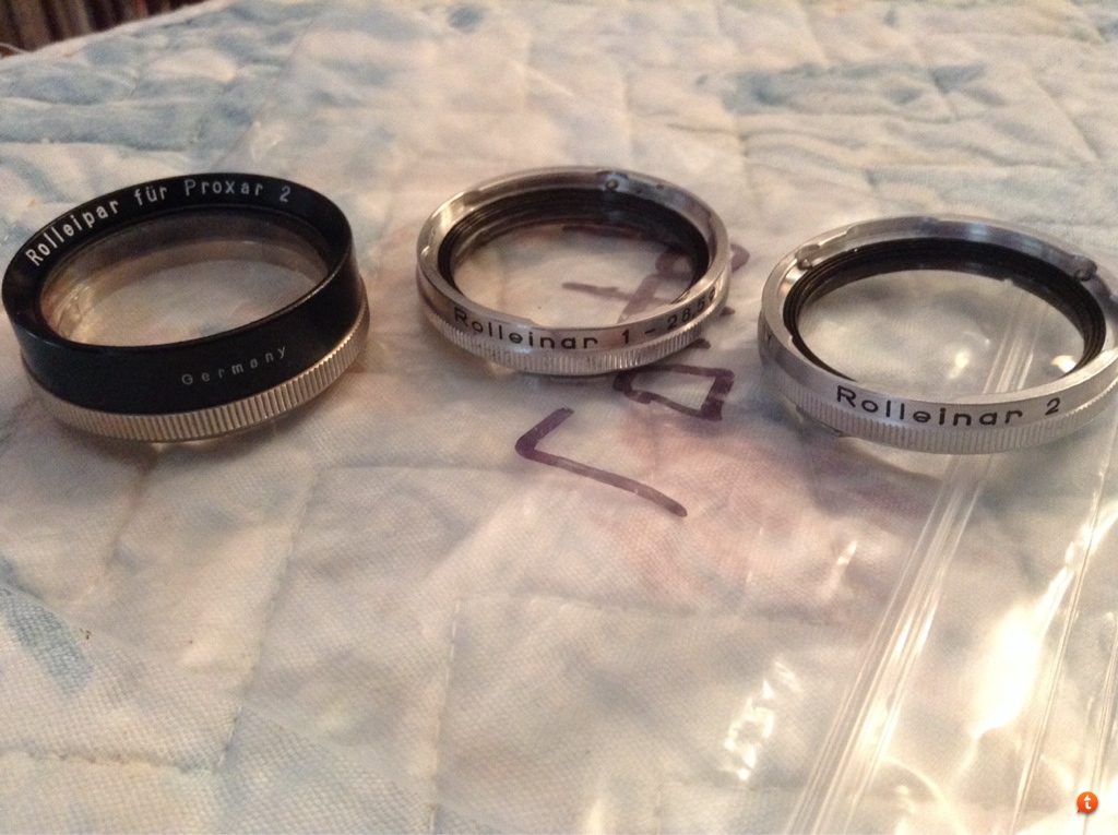

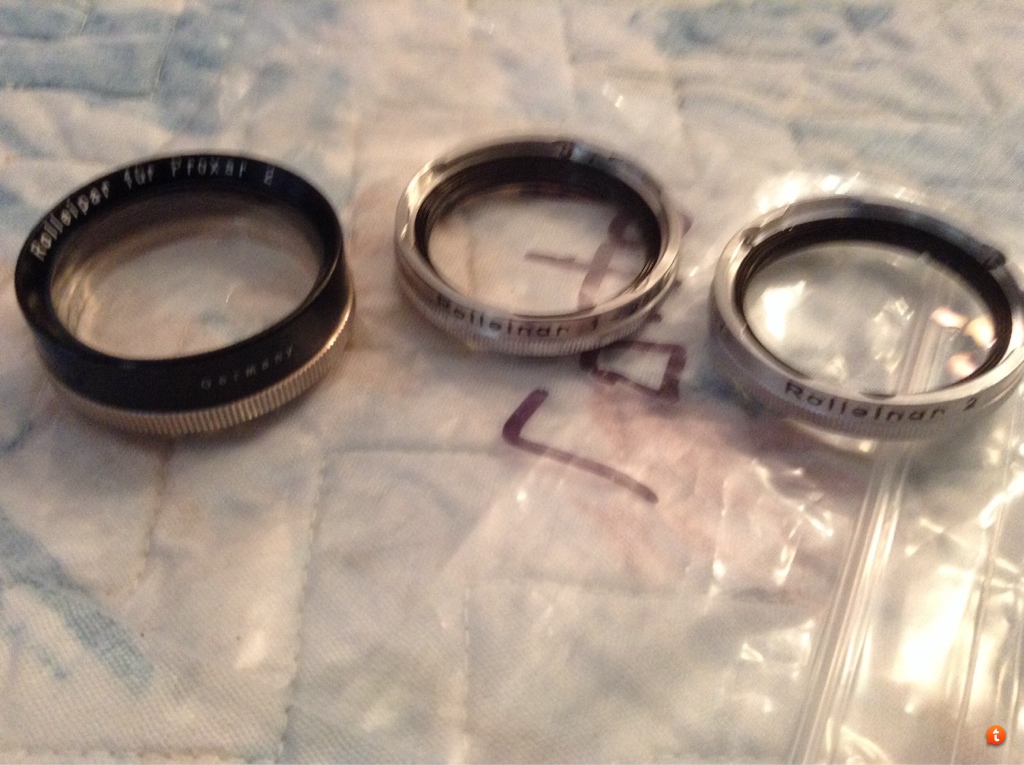

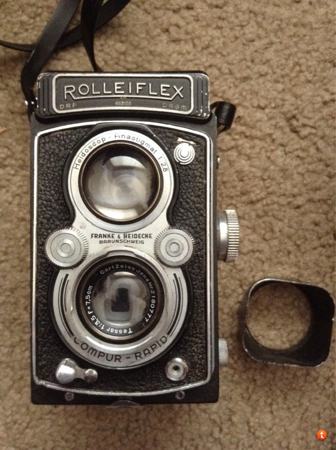

I've been shooting with an old Automat for a whole now (as it's a lighter daily carry than my Hasselblad!) and decided it might be nice to be able to do portraits as well as general photography. I know I need either a Rolleinar I or II for this, but I've run into a minor snag.
My Automat is one of the earlier ones with the push on viewing lens and the Bay I taking lens. I thought I had purchased the right stuff to overcome that, but when I developed the first roll every shot came out blurry (shooting at approx f5.8 or so...). What am I missing? Is there a part I don't have or something I'm doing wrong? I've attached pics of the camera and the 3 pieces I have - Rolleipar Proxar II and a Rolleinar I and Rolleinar II. Any help would be much appreciated!

You need one Rollienar I for taking lens and Rolleinar I + Rolleiproxar 1 for viewing lens. I belive Proxar I is for parallax error correction.
Similarly, one Rolleinar II for taking lens and Rolleibar II + Rolleiproxar 2 for viewing lens.

It looks to me like you need a Proxar 2 to go with the Rolleipar 2 on the upper lens, then you can use the Rolleinar 2 on the taking lens. This is assuming the Proxar 2 (which is what went with the older sets) is optically the same as the Rolleinar 2.
The Rolleinar 1 that you have can be used on the taking lens, but you will need the Rolleipar 1 and Proxar 1 push on lenses for the viewing lens.
In other words, you need three matched lenses for each closeup set (ie, 1 or 2). And I believe the viewing lens attachments will have to be the Proxar versions to work with the push-on attachment, since your viewing lens doesn't have the bayonet mount.

No, no, no, Proxar is the name of the Carl Zeiss made close-up lenses.
This is how it is:
For Rolleiflex in the 30's and 40's Zeiss made the Proxar close-up lenses. The came in sets in these mounts:
1 x 24 mm and 1 x 28,5 mm push-on for the Original Rolleiflex.
2 x 28,5 mm push-on for the Rolleiflex Standard, early Rolleicords without bayonets, and they can also be used on the Rolleicord II type 2 - type 6, and the early Rolleiflex Automats, since they can accept push-on accessories.
1 x 28,5 mm push-on and 1 x Bayonet 1, for the 1937-38 Rolleiflex Automat and Rolleicord II type 2 and 3, with bayonet on the taking lens only.
2 x Bayonet 1, for the 1939 Rolleiflex Automat and later, and the Rolleicord II, type 4 and later.
For these sets you could buy the parallax compensating prism Rolleipar/Rolleiparkeil to be used on the viewing lens.
From 1950 the close-up lenses were made by F&H under their own tradename Rolleinar, and came in bayonet mounts. First in three-piece sets, the lenses plus the Rolleiparkeil parallax compensation prism, and later in two-piece sets with the prism anc lens in one unit for the viewing lens.
What you want is either the Proxars in 2 x 28,5 mm push-on, or better, the set with 1 x 28,5 mm push-on and 1 x Bayonet 1, plus the Rolleipar in 28,5 mm push-on mount.
But bear in mind that close-up lenses give the lens a wider angle and can distort the face a bit, like giving the person photographed a bigger nose. (The Proxar was also sold as a simple wide angle accessory lens for large format cameras, and the Distar minus lens as a simple "tele" accessory lens). You can shoot portraits without Proxar/Rolleinar and crop during printing instead, if you don't really need to fill the whole negative.

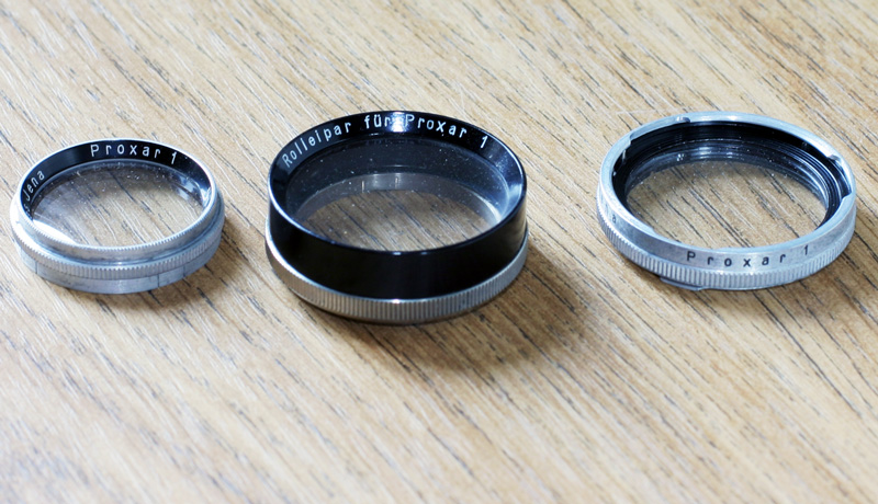

Here is what needed, for first Automat, if it is with a Rolleinar 1; for the viewing lens, put first the Proxar 1 push-on and then the Rolleipar (für Proxar 1) on it; and put the Proxar B1 on the taking lens.
However, all the Automat's but the later MX-EVS (K4B) can accept push-on accessories on both lenses.

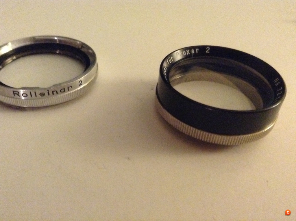

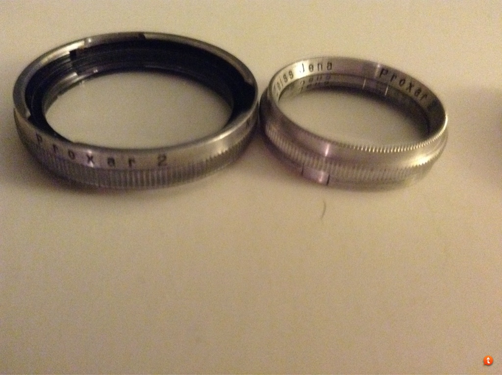

So I got one of the items off eBay today - what combo do I have to install these in? Here's the pics:
JPD
Mar 24, 2007
2,155
Sweden
That was quick!

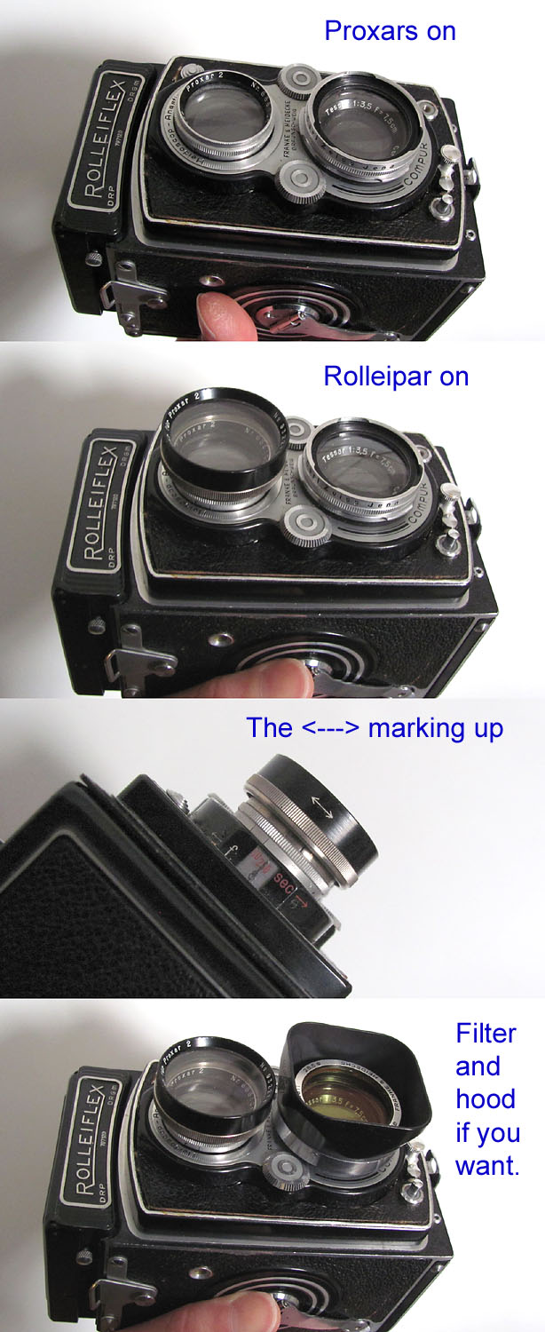

The bayonet Proxar 2 on the taking lens, the push-on Proxar 2 on the viewing lens. Then the Rolleipar für Proxar 2 on the push-on Proxar on the viewing lens. It should have a marking for which way is up. <-->
Here's one of my Rolleflex Standards with its push-on Proxars. It's the same for your Rolleiflex, except that it has a bayonet on the taking lens:
