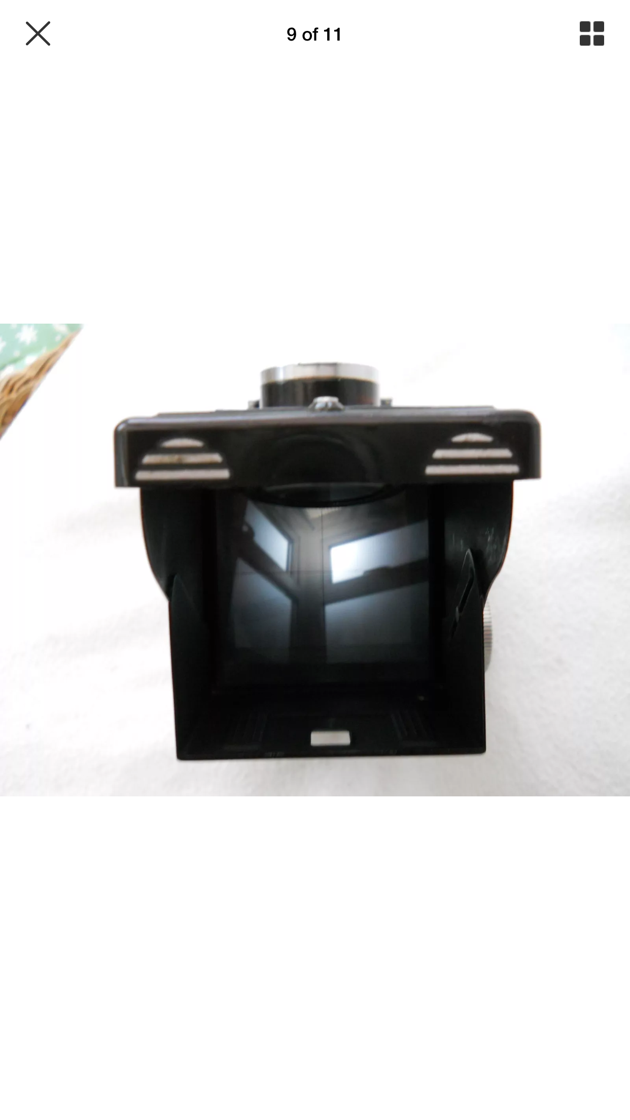

    Thinking of picking up a Rolleicord III, but I'm wary of having to also budget to replace the screen. What’s Phototrio’s thoughts on this one below ? It looks reasonable enough but I guess can never tell properly without trying it in the flesh

  6. 4season
    4season Member
    Ads Enabled
    Messages:
    433
    Joined:
    Jul 13, 2015
    Shooter:
    Plastic Cameras
    Before you spend money on a new screen, make sure the mirror hasn't lost a lot of it's silvering. It's a pretty inexpensive and easy fix.

  14. OP
    Ste_S
    Ste_S Member
    Messages:
    279
    Joined:
    Nov 10, 2017
    Location:
    Birmingham, UK
    Shooter:
    Thanks for all the replies folks. I'll take the plunge with the camera, I've communicated with the seller and the mirror is good. If i find the mirror is too dim to use I'll be back !
