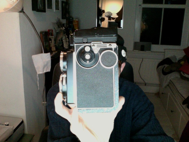

    I purchased what I think is the rolleicord 5b from a chap in canterbury, with a 35mm rolleikin back included, both for 50 pounds, Ive been meaning to post up for a while, I did put a film into it a little while back, but Unfortunently as I wind, it doesnt stop... Ive checked the teeth, there doesnt seem to be any where, I did get some previous help about a button you press each time? but nothing happened, any tips on how it works. thnks in advance

    ive checked if the top spool is spinning the part driven behind it via the teeth & its moving fine, on this side, is there meant to be a 12 Counter?! because this one reads 36, but on the other side I have a 12 count.

    The 36 counter is for Rolleikin. The 12 counter is for roll film. Does the 12 counter change frame count as you wind? I think the stop mechanism is in the counter. You can remove the counter and see if something looks bent or broken. The silver knob in center of counter is a screw.

    I think the fact that you have a 36 counter means that you still have some of the Rolleikin parts fitted.

    I have a Rolleicord va2, and the winding nob is on the right hand side together with the frame counter, focus on the left, I had problems with the film wind, in my case it did'nt wind on far enough and overlapping frames, but a service by Newton and Ellis sorted the problem out, but it is just possible that part of the Rolleikin adaptor is still in place, but I would get it serviced at www.newtonellis.co.uk They do great work, and you have one of the best cameras around for 120, second only to a rolleiflex, worth getting done,Richard

    thanks to everyone for your help, I do really appreciate it, gonna get it sent off in the week if I can, one last thing, on the other side from my latest photograph is the 12 count, but should the counter I photographed be a 12 count two? Unfortunetly I dont have this, will have to keep an eye out on ebay or the sale section, see what pops up.
    heres the other side, then ill leave it at that, thanks all for your help,
    Much appreciated,
    Joe

    If you are using roll film, don't use the Rolleikin counter (the one that goes to 36), only use the 12 counter -- the one shown in your most recently posted photo.

    One other thing to check before you send the camera for repiar, is the silver "tab/button" that can be seen on one side of the open back. That engages/disengages the 12 counter. Make sure it is being depressed by the back when closed and locked.
