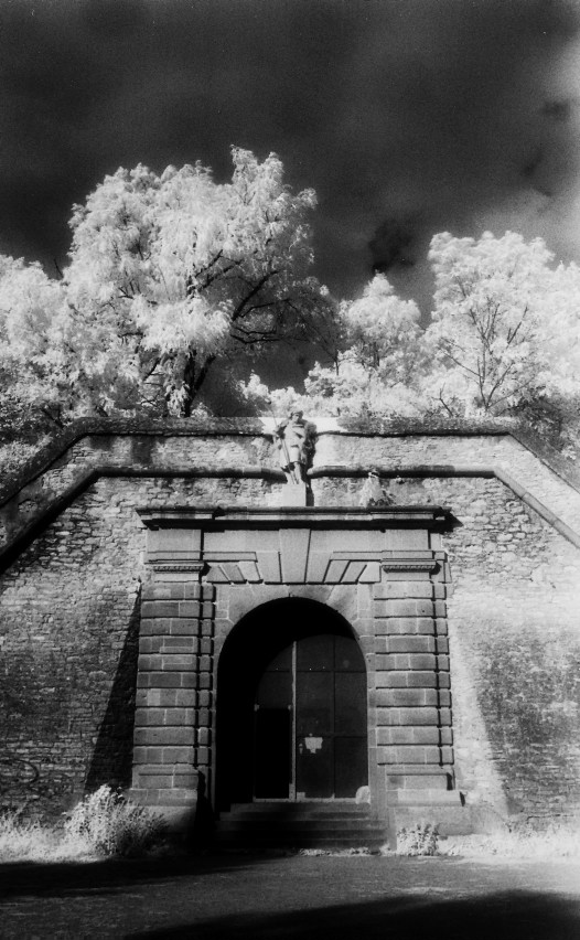

If you have shot this film with good IR effect please post with shooting data.
If you want a stronger IR effect with the same filter and a similar look as the good old Kodak HIE you will be better off with an Efke 820IR:
(This was the "Aura" version that adds some extra blooming to the highlights)
