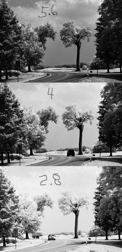

I was out shooting yesterday with Maco and took a new roll of Rollei IR along with me.
After shooting a roll of Maco, I loaded my first roll of the Rollei film and shot it as a test.
I use a Hoya R72 (=89B).
I did not find any recommendations for XTOL for this film, so I developed both in the same tank - XTOL 1+2 for 16 minutes. I understand that this combo is probably not correct for the new film, but it works great with the Maco. My first frame of the Rollei was exposed the same as I would the Maco. That negative is more than 1 stop too thin.
I think this new film might need more development rather than exposure. Here in these two frames with same exposure and development, the Rollei IR does not have as pronounced “Wood effect” as the Maco. (2 seconds @ f/16 with R72 and 4x ND Center filter.)
I think I will try a test series of exposures of the Rollei IR with XTOL 1+1 for 14 minutes to see if I can have better luck.
Rollei IR has spectral sensitivity up to about 730 nm, Maco IR 820c had spectral sensitivity up to 820 nm. It is obvious that the wood effect can't be so strong with the Rollei. They are totally different films. Maco IR 820c was an Efke product, while Rollei IR is actually Agfa aerial film. The Agfa also has a straight characteristic curve, while the Efke had a very pronounced toe.
Today - Mostly cloudy but these were taken at near Sunny 16 Conditions when the sun came out from between them and gave distinct shadows.
1/30th second exposures with R72 filter.
Developed in XTOL 1:1 for 11 minutes.
I'm going to like this film.
