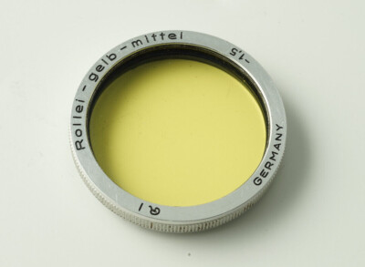

I recently acquired, at a photo fair, a Rolleicord Vb at a price I could not pass. A lenshade was included. I think I need a medium yellow filter; they seem to be scarce, more so than light yellow.
I'm thinking of buying a light yellow filter, and substituting the glass part with a medium yellow from a surplus filter, cut to size by an optician (after all they cut prescription lenses to the complex shape of the mount chosen by the customer).
My question is whether a Rollei filter can be easily dis-assembled (e.g. threaded retainer ring) versus permanent construction (e.g. press-fit).

Yes, the filter unscrews. Put the bayonet side on a rubber stopper, then use a rubber stopper on top, press down, and rotate standard, counterclockwise.
This is one of those threads that will not move not move and then you relax and press again and relax and BOING! off it comes. You might try some double sided top on a block for the top so that you can turn with less downward pressure.
There is a spring washer inside. On the back side, I think. The gap for the glass is wide and the washer keeps the glass pressed to the front surface. Or maybe it sits on the front and pressies the glass to the back I forget. Well, be aware of the thickness of the glass when making a replacement.
Or your can get a Gelb Mittel from Tim at FilterFind.

Rollei Gelb Mittel in Bayonet 1 really aren’t scarce. They are just scarce at inexpensive prices. Other brands in Bay1 are more affordable.

Bernard, can your optician cut glass, or just plastic? As far as I know, almost all eyeglasses now have plastic lenses. For med yellow, you will need to buy a sacrificial filter from which to extract the glass.
Opticians have cut filter glass for me many times, to fit Rollei mounts and different slip-on mounts.

Finally I found the filters (yellow + orange) that I "needed" at a price that I deem reasonable: 25€ apiece, 8€ combined shipping.
