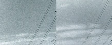

By a sheer coincidence I happened to take the same picture on two rolls of 35mm Tri-X rated at EI 400. One roll wound up getting developed in FG-7 1:15 in a 9% Sodium Sulfite solution for 7 Min, (which was my suggestion in the "Opposite of Rodinal" thread)., the other in Rodinal 1:50 for 13 Min.
No big surprises but I thought that since I had them, I'd post them for anyone that might have an interest. They are sections of a flatbed scan off of prints. The full neg Rodinal print can be found in the Critique gallery [Lake].

Soooooo Neal....Rodinal on left???? :wink:

Neal, Thanks for the post..interesting, while the grain is noticeable so is ..hmmmm! I guess what is perceived sharpness (or at least contrast) in the wire/lines. Will take a look at the print in the gallery. Now if you had just one more roll, and some X-tol to add a little Rodinal to... :wink:

Interesting. Out of curiousity, could you post scans of the negs? Possibly expanded by 4x or 5x? I'm wondering what the wires look like at higher magnfication.
