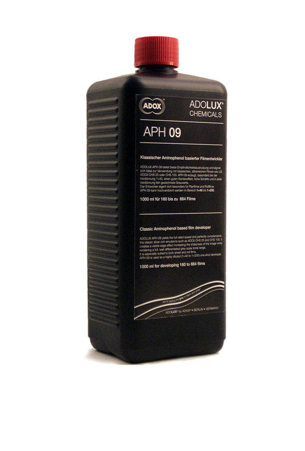

jandc
Jan 29, 2004
601
jim appleyard said:
Could you possibly give us a few more details on this?
This is the Adox version but the bottle is the same.
Lee L
Nov 17, 2004
3,281
Christian Kolinski said:
Well, if you compare the bottles Rodinal ships in and those R09 is, you may find a quick answer to why R09 won't last as long as Rodinal.
Christian
My 250 ml R09 from JandC came in a rectangular opaque brown #2 PE plastic bottle. It has a separate internal plastic stopper that folds back over the lip of the opening and then a standard plastic screw on cap over that. Looks like the 1 liter bottle in the shot from JandC, except smaller.
My 125 ml Rodinal came in a PE-PA plastic (no US recycling type number stamped on it) rectangular opaque white bottle. There is no separate stopper, but the screw on plastic cap has an internal rim designed to seal against the inside of the opening.
My 500 ml Rodinal came in a translucent rectangular #2 PE plastic bottle with the same lid type as the 125 ml Rodinal.
Maybe R09 bottles have changed, or it comes in different bottles in Germany and overseas.
The only differences in my bottles, the extra (and very tight) plastic stopper in the R09 bottle, and the translucent plastic on the 500ml Rodinal, would both argue for longer R09 shelf life.
Agfa has changed the bottle numerous times in the 30 years I've been using Rodinal. I haven't heard that this has changed shelf life.
So what's the quick answer? I'm a little slow (and long winded).
Lee
