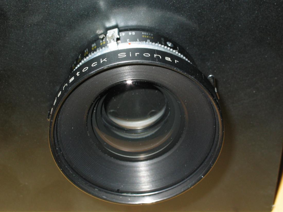

    I have a change to purchase 150mm/f5.6 rodenstock sironar lens at very low price. I could not find any information regarding the older model. This is "plain" sironar without the S or N. I think this lens is made in 1977-78.
    What is the image circle for this lens? Should I buy the lens, or should I invest a little more for -S model?
    Help would be appreciated!

    The image circle should be plenty for 4x5 inch.
    I have one, I believe, and it is a good lens, use it in architecture verry little.
    Check the coating, otherwise you will have a flare issue. Never had problems with mine though.
    Is it on ebay ?
    The later ones have better coatings (and are less prone to flare).
    It depends a bit on what you can spend.......

    I think the lens is uncoated? At least it's not multicoated...

    Timo - you can find out how old your lens is be looking at the serial number and comparing it to this list - http://www.thalmann.com/largeformat/agevs.htm
    I have asked similar questions recently and the synopsis is - If the Len looks clean (no dents on the lens body/scratches on the optics/cloudiness looking through the lens) and the shutter is good then any post 1970 lens will out perform your expectations by some considerable margin.
    If it’s a nice lens for a good price you could buy it and in the future trade it in if you ever felt the need for a newer/new one
    Good luck
    Martin

    I have one of those too. It's a good lens, single coated (mine's c1968), plenty of coverage for 5x4, sharp, though it's beginning to develop a balsam fault. Your's looks very clean.

    I bought mine in 1972. I worked for a small camera store in Nashville so I bought it on the "camera store employee plan" which means I got it for 1/2 the list price from the importer, Berkey Marketing. In the early 80's the front element started separating so I sent it Berkey who sent it back to Rodenstock in Germany who repaired it at no charge. It is one of my favorite lenses. The newer ones are a tiny little bit sharper as Rodenstock tweaked the formula a little and the multicoating is a big plus for color work. You should be happy with either.

    The many of the plain ordinary sironars of this time frame had lens separation issues. Rodenstock had not perfected the new synthetic adhesives at that time. I have had 3 of mine from this time frame separate. There may be a reason the lens is cheap.
