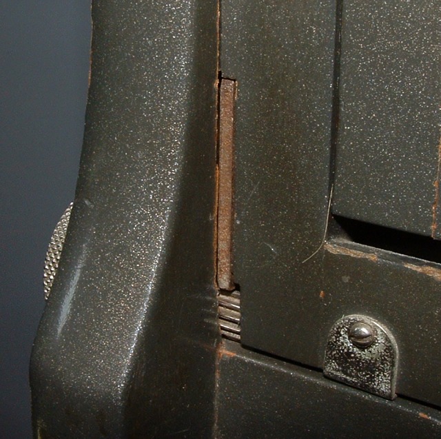

On my Agfa 8x10, the rise and fall is locked by a little plate on the inside of the front standard. It has internal teeth which mate with the rise shaft pinion and lock it when the pinion is pushed to one side after setting the height. The lock is NOT friction on mine.

John -- it doesn't look like there's any plate to lock the standard.
It's there. I can see it in the picture on yours and I've attached a picture of the (worn out) one on my own Agfa. The bottom side of the little clip that I'm showing here has (had) teeth cut into it and those teeth are worn away. That rusty little vertical metal piece is what I'm describing.

John,
You're right, I have that same little plate. When I push in the knob its teeth kind of articulate with the ones on that plate, and that prevents it from turning and falling down.
