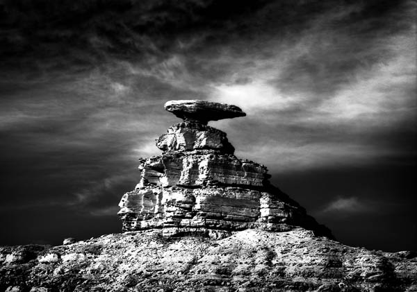

Donald points out an important point in all photograpy, especially for dramatic effects. Selecting a high contrast fine grain film works better for me than increasing development. Kodak Tech Pan processed in an active developer (I usually used a prewash and print developer at about four minutes) gave high contrast without much grain. Shadow or highlight detail suffers where the foreground already has much contrast. In the red rock country of the American west, it did work.

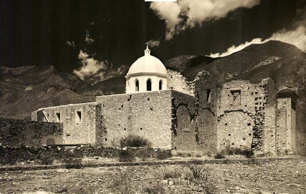

Not only do I can confidently assert it, I can show you.....12x20 fp4 with red 25 and pola. I really dont care what AA used or not, I care how to get the effect easily. BTW, this was taken with sunny sixteen rule (forgot my meter) plus a 12x exposure factor.

Dear Jorge,
Thanks for the picture, which indeed looked very good as far as I can tell from the monitor on my internet computer. If it looks good on that it's probably excellent on anything else.
Even so, you have to allow it's not the ONLY way.
