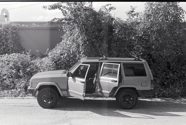

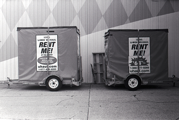

On recent rolls from my IIIf, the right half of each frame is slightly darker than the left. I've attached a few examples. Do you think this is a shutter problem?
