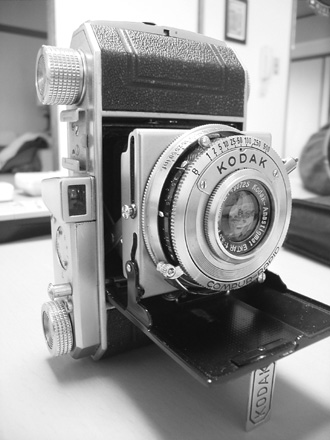

    Hi. I have two ID questions about this camera, and one service question.

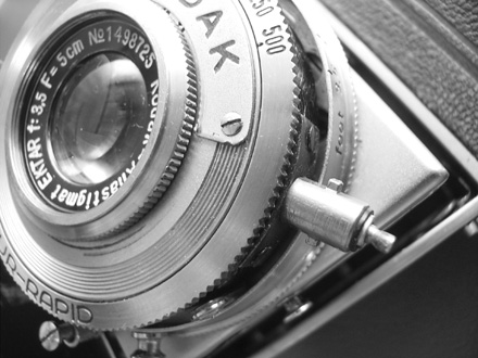

    1. What is the broken thing projecting from the side of the shutter housing? It has some kind of spring loaded brass plunger coming out of it, and it's clear that something has broken off the top of the rod. See picture 1.
    2. What is the geneology of this model? Pictures I've seen lead me to believe it's a type 010, but there are some minor variations. Mine has a viewfinder that seems to be a separate piece, rather than integral with the entire top plate. Mine has an Ektar lens rather than the Schneider lens I see in pictures of other 010s. See picture 2.
    3. The frame counter and top shutter release plunger are unreliable. The frame counter dial doesn't always spin when the film is advanced, and the shutter release doesn't set. They seem to be connected. Anyone know how difficult this may be to repair? At the moment, I'm spooling the whole roll of film onto the take-up spool, using the rewind knob to "advance" the film (because the counter dial moves perfectly in reverse), and using the shutter release on the shutter itself rather the one on the top plate.
    Thanks for any help you can offer.
    Matt

    Looks like a type 149 - Retina I prewar. Not imported into US by Kodak.

    The post on the side of the shutter is the old locking flash connection.

    Okay, I've done some research, and found that it's actually a type 148. It has an Anastigmat Ektar rather than the type 149 Retina Xenar.
    There's a great list of models at the link below.
    http://www.wctatel.net/web/crye/retina.htm
    Thanks for your responses!

    The "broken thing" is an ASA type bayonet flash connector. Paramount will make flash sync cords that mate to this.

    ps. you can buy an adapter for that bayonet flash sync for regular pc flash.

    You could have either the Model 148 or the Model 010, which was produced after World War II using various prewar and wartime parts. Likely, it's the 148, although the 010 is nearly identical. The 148 and 010 have two lugs on the film counter dial, which yours appears to have.
    The 010 had EK before the serial number. The 148 had no such designation.
    There were so many variations of each camera that it makes it really difficult (and fun) to try to figure out which model it is. Some cameras were sold only in the U.S. Some cameras were sold only in Europe.
    The probelm with the shutter release sounds like a lubrication issue.

    The camera he shows has separate stampings for the viewfinder and film counter housing, which I thought makes it definitely a 148. I.e. some 148's had two stampings, some had one, but all 010's are the one-piece stamping.
    There's an obscure difference in the indicator mark next to the film counter dial that's supposed to definitively divide 148's from 010's, but I can't remember what it was. It was in an issue of Photoshopper a few years ago which I've since tossed.

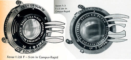

    The f:2,8 Xenon was before the war actually a Xenar with an extra front element to raise the speed and give better corrections at full opening. It was called Xenar on some cameras, but Xenon on the Retina. The f:2 Xenon was also different from the one on the IIIc. Both the f:2,8 and f:2 were redesigned to be able to use the wide and tele front components. (they are the same lens except for the size of the opening)-
