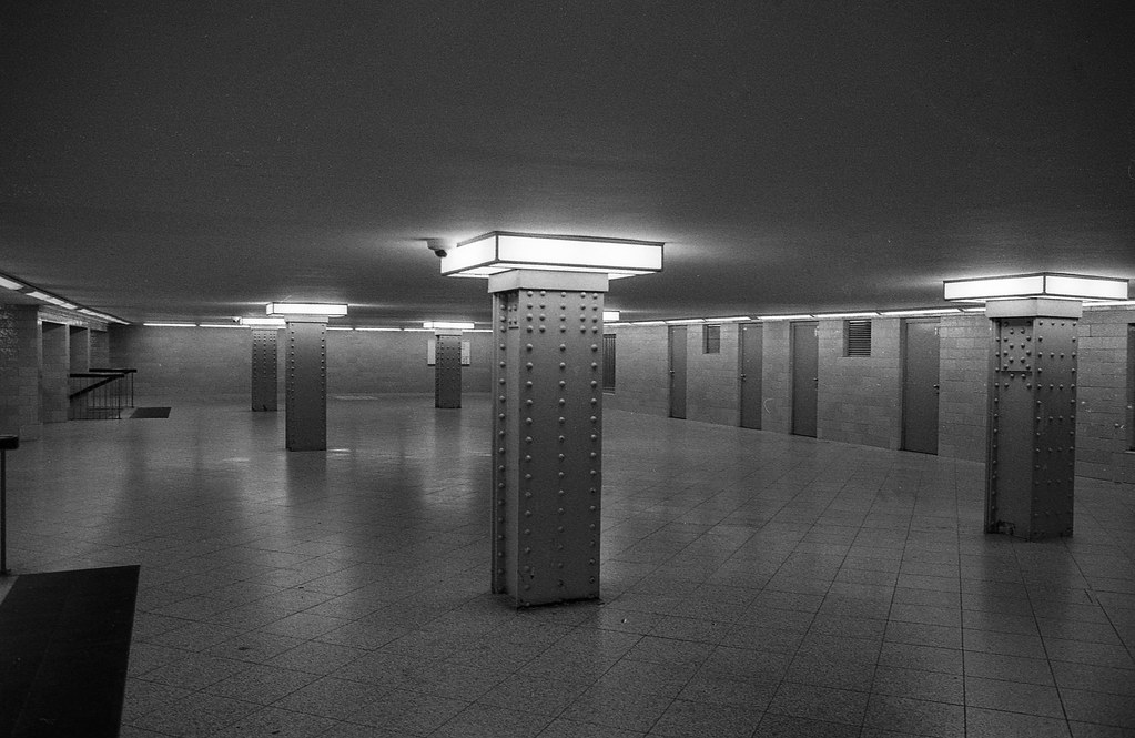

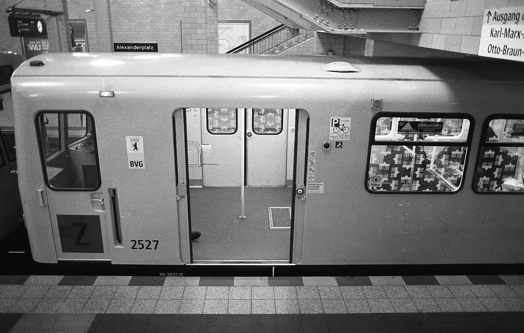

    I have several questions and i dont know if this is the right section but here it is nonetheless
    I noticed that all of my photos have these "scratches" - why is that? The lenses are squeaky clean, i have put brand new sealings inside the camera (AE-1) and have blown out all the possible dust out the camera with an air spray.
    [​IMG]img147 by odotpap, on Flickr

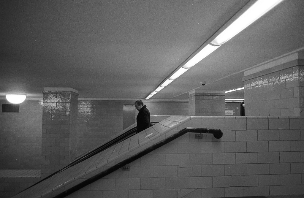

    This one has some ugly dots (top left) - is this from developing? What mistake did i make?
    [​IMG]img155 by odotpap, on Flickr

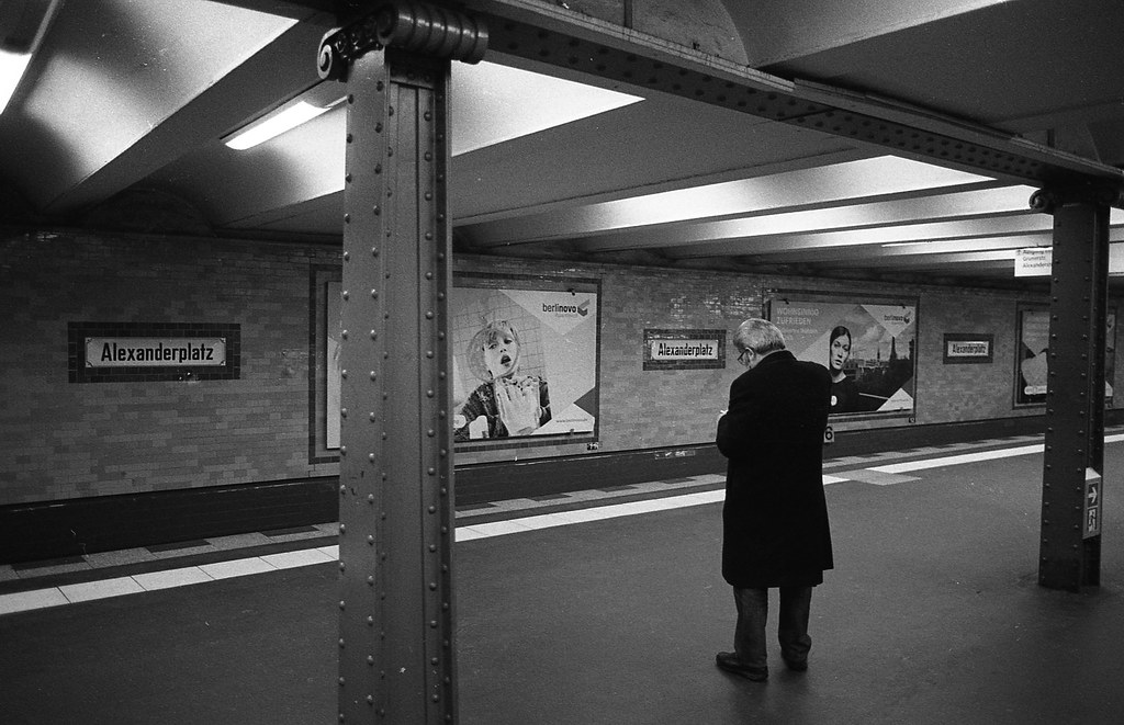

    And this one here was shot on the same roll of film but its greytones are so much different than the rest - why?
    [​IMG]img148 by odotpap, on Flickr

    I can see them. The first image looks like a dirty scan. If the second image is from a scanned print I would say you have eithe small air bubbles adhearing to your film during processing or dirt getting on the film in your camera.
    Hard to say without more info from you.

    Hey, what infos do you need? All images are scans from negatives, not the images themselves. As far as dirt, the possibility is nearly zero that the negative has had some extra dirt.

    Check your scanner for dirt on and under the glass. Have you looked at the negs with a magnifying glass to see if you can see what might be causing the blemishes? If you can not see anything on the negs that would cause these marks then it's your scanner. If you can see little round clear areas in the sky that would cause your black dots then it's either in the processing or from your camera.
    Rebate is the unexposed areas on the film. Typically where the sprocket holes are for 35mm film or around the edges for sheet film.

    I think the possibility is much higher that there is dirt on the negatives. Probably got onto the film when it was hung to dry after developing.
    Grab a magnifying glass and look at the negative directly.

    - Scanner is brandnew, has no scratches and is always kept clean
    - Scan results from my other camera did not have any of these distortions, which means its either the camera or from my first attempt of self-developing
    - The bigger, more noticeable scratches can be seen on the negatives

    ok, what kind of dirt could it possibly be? The negs were hung in the bathroom on top of the clothing dryer rack, attatched to the door. Bathroom has hardly any dirt, it is clean for the most part, unless you are counting all those times i came home drunk and "missed" :D Btw, only the bigger, more noticeable scratches can be seen on the negatives

    If your scanner is spotless, then the white specs are from linty things and dust sticking to your negatives whilst drying. You'll need a cleaner space to hang them up to dry. The black specs however, means that there are holes in the emulsion, which could have been caused by bad fixer... or a worse scenario is manufacturer issues during coating... but I doubt it. Which film is it?

    I don't know what the humidity is like where you are, but a very dry place kicks up a lot of dust into the air. If you can raise the humidity you'll notice a huge improvement in dust control. If you can run hot water for a bit, or boil a kettle or pot with water.

    The Film is a HP5+ (30m bulk roll). I can try different rooms but the bathroom is still the cleanest and most humid place that i have. The other thing, creating even more humidity would create mold in the bathroom. One more thing, i added the wetting agent to the last rinse water as the last step (as advised in the Ilford developing manual) and theres a possibility that i may have added a bit too much since it was really bubbly. I dunno if it has something to do with it, i am just looking for ways to understand all of this and improve.

    Too much wetting agent sometimes is not good. I put about 1mm of wetting agent per litre of water to which I add 50ml 91% Isopropyl Alcohol. Speeds up drying.

    Shocker: I dared to clean the negative with a cleaning "rag" for lenses and as you can see, most of the stuff is gone! I guess it is dirt, dust etc, the question is where did i make a mistake?
    Original scan
    Cleaned scan
    [​IMG]img180 by odotpap, on Flickr

    Dust, tiny fibres etc. My great enemy is dust. By very careful when cleaning negatives. They are easily scratched. A squeeze-bulb blower helps or canned air. An antistatic brush designed for negatives is also useful. There is something else wrong with the picture of the traffic: a white splodge on the positive (black on the negative) on the right hand side.

    In your first example (the one you cleaned) those marks may be residue from the water. If you're mixing wetting agent with regular tap water, any minerals or impurities in the water can still leave marks on the film. You can use tap water for most of your rinsing, but use distilled water when you mix your final wetting agent.
    It's usually OK to use a very clean lens cloth or Kim-wipes to gently wipe fingerprints or oil from your negatives, but if there are deposits or other dirt on the film, this may scratch it. I would just re-soak the negative for a few minutes in the distilled water / wetting agent solution and hang to dry. For the first hour or two while film dries, it's important not to disturb the air around it as any airborne dust will stick like a magnet.
    The spots in the sky in your 2nd and 3rd image are a bit tougher to identify. Could be airborne dust, could be particulate matter in your final rinse. Less likely that it's a problem with the film and it doesn't look like a scanner issue.
    Your last image with "muddy" tones may just be underexposed. The negative itself would look thinner and less "dense" than other shots on your roll. If your scanner is set to automatically set the exposure that it reads from the negative, this would have been the best it was able to do with the underexposure.

    Hi, the problem of dust getting on the negatives after processing is sort of the "dirty little secret" of photo lab work. If you've learned everything from books, internet, and that sort of thing then you were probably "not exposed" to how much of a problem dust is, or at least CAN be. The literature may say things like "handle film in a clean environment" or "avoid dusty conditions," and that sort of thing, but without in-person guidance it's pretty vague exactly what this means.
    If you ever worked in a serious photo lab, you'd learn about this quickly. Every time you mishandle film, someone would let you know ("hey, don't swing that roll around," "don't lay that film down on the counter," "don't unroll that film so fast - do it slowly."). But on your own, dealing with dust that's largely too small to notice, or even smaller, it's hard to get a handle on this.
    I've spent a lot of time in high volume labs, where dust can be a major problem. In pro work, it's taken as a fact of life that you need people who are skilled at "dust spotting," the technique of using a fine-tipped "paint brush" to delicately apply inks or dyes to the white (on the print) dust spot to hide it. Although these labs use a great deal of care to avoid dust problems, they do happen and must be dealt with, and "dust spotting" larger prints is usually more economical than reprinting.
    I could probably write 50 or 100 pages on dealing with dust, but the basic rules are 1) try to keep relative humidity in the general range of 50% where you work (below ~30% static electricity doesn't bleed off the film easily, and it's like a magnet for dust; above ~70% your equipment can rust and mold grows readily). 2) Don't leave your film open to the environment any longer than necessary - keep it in protective enclosures (such as negative "sleeves") as much as possible. 3) Don't stir up dust in your work area; for example, don't sweep with a broom or otherwise stir up dust even an hour or two before getting the film out - very fine dust particles can stay in the air for a LONG time, especially if the air is being circulated. 4) Move fairly slowly when you are handling film. As others have said, people are large sources of dust in darkrooms - we shed dead-skin particles, our clothes carry all sorts of particles, etc. If you were to go into the darkroom and start slapping your hands against your arms, your legs, and your body, you would most likely put an incredible amount of tiny dust particles into the air. So just don't make any violent motions or run around while you have the film out - try to move slowed and deliberately when handling the film.
    There is a lot more to it than this, but hopefully this will help make you aware of what a touchy issue dust control can be.

    Clothes dryers throw tremendous amounts of lint into the air.
    And scanners will make every piece of lint or dust or anything similar on or near your negatives appear obvious!

    The first image is dust and little hairs/fibers on the negative. I have a cat, and her little hairs are a pain for scanning :smile:
    One tip I've read, is to run the hot shower for a minute before you hang up your film. The shower humidity will make the dust fall out of the air. I hang my negatives to dry in the shower with the curtain closed.
    I too have had the black dots on my images like your second photo. They don't seem to wipe off. It's like they're stuck to the emulsion. I'm not sure what causes it bull I'll be following the thread here to hopefully find a solution.

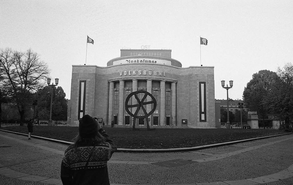

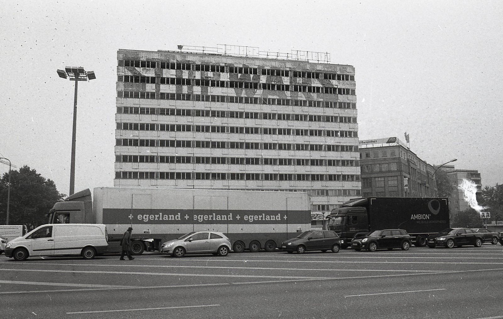

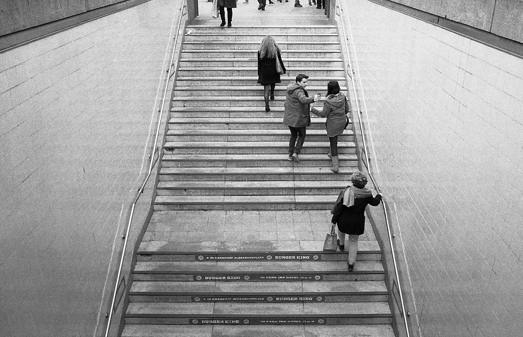

    The second developed roll turned out to be much better, i did change my clothes for developing into functional sports clothes (you know, sweat absorbing nylon/polyester stuff for running) to minimize dust and it did help. Other than that, i went about it the same way. I did clean up a few dust spots here and there.
    [​IMG]img192 by odotpap, on Flickr
    [​IMG]img198 by odotpap, on Flickr
    [​IMG]img209 by odotpap, on Flickr
    [​IMG]img217 by odotpap, on Flickr
    [​IMG]img211 by odotpap, on Flickr
    [​IMG]img197 by odotpap, on Flickr
