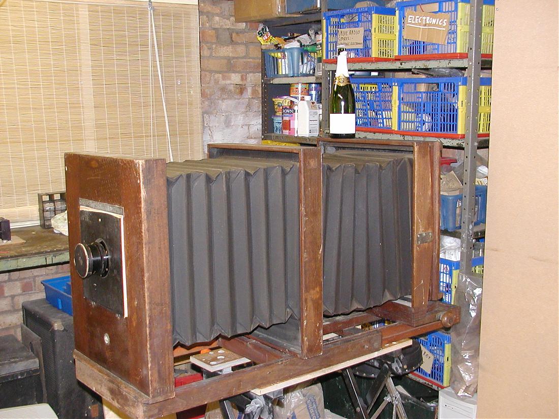

I managed to find a picture of the camera (I knew I had one on my hard drive somewhere!)
This was taken after I cleaned it up, but before attempting any sort of restoration.
The champagne bottle on the top gives it a bit of scale...
Steve

A wonderful beast! Does it take good photographs?
Solid walnut?
I must admit I don't really know what mine is made of. I have assumed mahogany, but only because I didn't know they made them out of anything else! :tongue:
Mine came with a brass Ross lens of about 10" focal length (for whole plate, I assume). It was mounted on a deeply recessed panel (more of an internal box, complete with brass tube and flange for the pneumatic shutter, alas not included).
I bought the camera really because I have quite a big lens collection and when I get the camera up and working I should be able to put any of my larger lenses on on it :smile:
Steve
