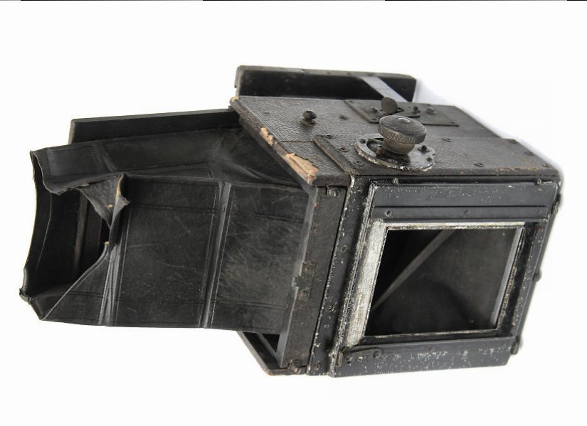

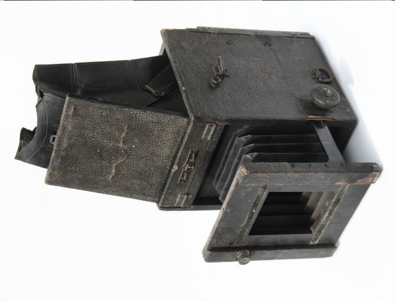

(there was a url link here which no longer exists) I mentioned I was going down the Reflex route, it's part of the learning curve in camera restoration.

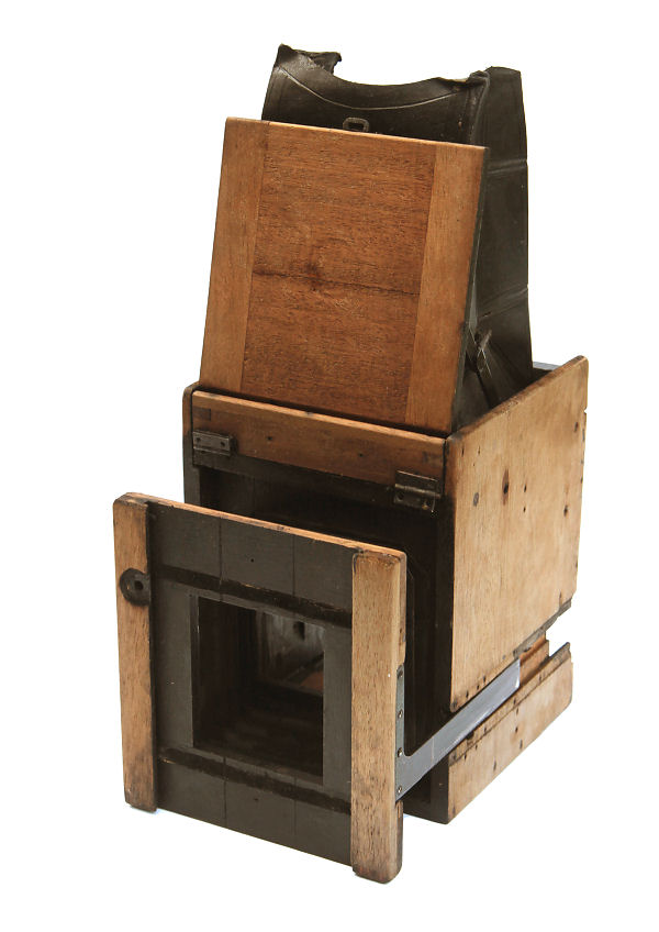

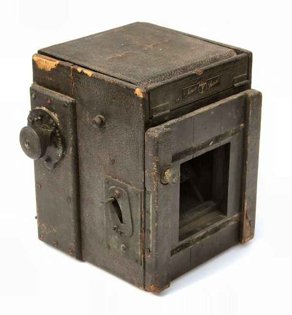

The camera arrived yesterday and after photographing it this afternoon restoration has begun. I knew from the outset that the shutter was broken, there was no focus screen, lens/lens board, and the front silvered mirror was useless. In addition the focus hood is coming apart.
The camera had been poorly stored and the covering had become damp at some stage, once dried out it was starting to flake off so I made thedecision to recover the camera with similar style Morroccan grain Arbitex leather. There was evidence of a crack in the wood of the body so removing the covering woulsd make this easier to repair.

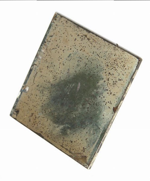

The camera and the front silvered mirror.

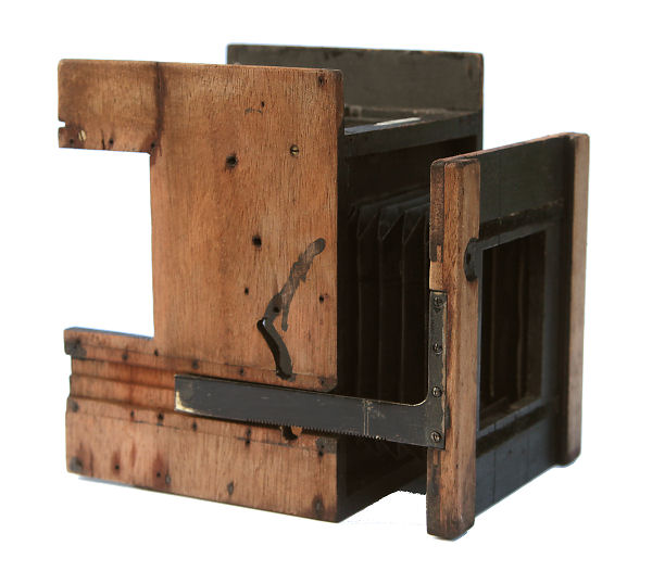

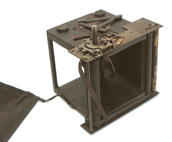

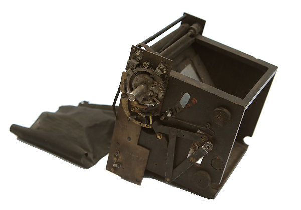

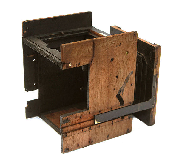

Taking the camera apart turned out to be relatively straight forward and I now have the shutter module out, intact. Steve (steven_e007) gave me some hints, as did Tomosy's book on Camera restoration but unfortunately my camera differed in the position of the hidden screws :D

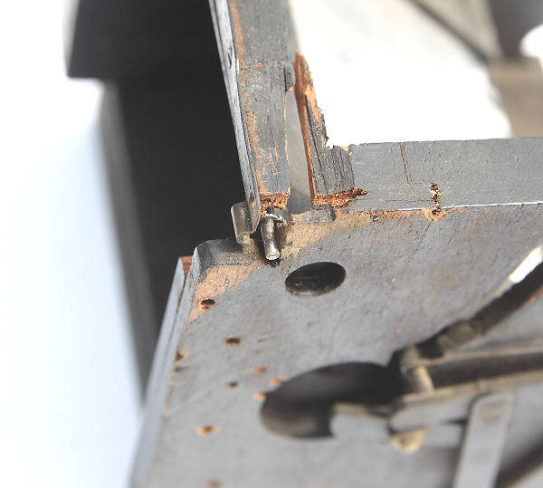

With the shutter out I dampened the covering on the body and scraped it off, I found two ther significant cracks in the woodwork but they will be easy to repair. There's also a crack in the frame of the shutter this would probably not be an issue but a drop or two of Super glue and it's fixed.
The body-shell. The third atached photo shows the most significan crack, this was through the covering as well. Tomorrow I'l fetch my clamps and repair the cracks in the woodwork, then I'll repaint the interior of the camera and the shutter module with matt black acrylic.
Then the harder part re-building the shutter, first I've got to figure out how it works.
I've worked on a few Graflex shutters but they are quite crude in comparision as they have just one shutter blind and depend on coice of slit & tension, a bit like a Thornton Pickard roller blind shutter except 4 slit widths instead of one. British (and European) reflex camera shutters (and other focal pane shutters) use two blinds and your shutter speed dial adjusts the slit width.
Fun for tomorrow . . . . . .
Ian

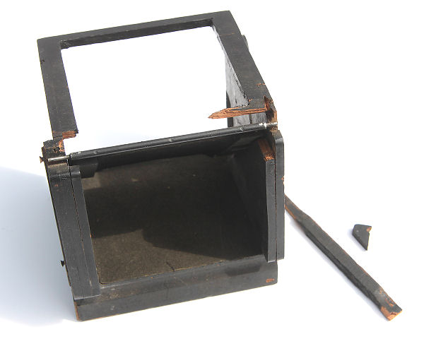

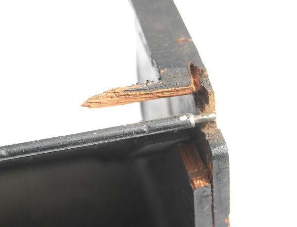

Unfortunately the damage to the mirrox box was more severe than it first appeared, it is repairable however.
All the significant damage is to the top right hand corner of the rear of the camera indicating that it must have been dropped at sometime.
Ian

The restoration has had a slight hiatus. The mirror box is now re-glued and rigid again but I'm waiting for (there was a url link here which no longer exists) (first/front surface) to arrive from Vacuum Coatings Ltd (Scientific Mirrors) and until that arrives I can't really begin to re-assemble the shutter or fit the new shutter curtains.
I have cleaned the shutter control mechanism, it was tight and difficult to move so needed a good soaking with WD40, then I washed it well finally making sure there was no trace left of the WD40 using methylated spirits.
The new Moroccan grain Arbitex leather (bookbinders cloth based material) arrived yesterday and I've recovered the hood, front standard and a small side panel so far. The body itself can't be re-covered until the shutter's been re-installed because there's an aluminium plate on the bottom of the camera that has to be removed.
Ian

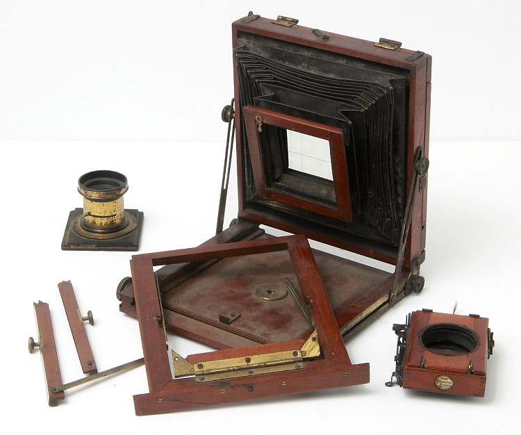

It is amazing how different your camera is to mine, considering they are supposed to be the same model - or at least have the same name. As far as I know 'Ruby' refers to the shutter - which appears to be the same - and I thought 'Junior' was the size and 'Special' was the model? Maybe it is like the menu in Greek restaurants I went to once - everything was a 'special' :D
I've spotted two on ebbbeeeegeeebay, one which looks the same as your camera and one more like mine. I think these reflex cameras were produced for many years and I suppose there may well have been more than two versions, even with the 'Ruby' shutter? I'm pretty sure my model is the same as one in an advert I have from 1927.
I had to chuckle about the hidden screws. I suppose there's no point in hiding them if they always hide them in the same place!
Unlike your camera mine has no metal insert inside the wooden box (your camera seems to have a 'mirror chamber' - if that is a good name for it?). One advantage for me in this arrangement was that I could work on the shutter without fitting the mirror. I was able to slip it in and out of the mounting rails fairly easily with the camera assembled and so I actually left it out most of the time so as not to damage it.
I also had a new mirror made by Scientific coatings a few weeks ago... they only charged me £15 for mine, though :wink:

This evening I had a good play with the shutter mechanism and it should run very smoothly now, when it came it was almost solid. I've written my name and the date of restoration on the mirror box in pencil below an original TP pencilled number.

Mine is a 3 1/2 by 2 1/2. That might explain some of the differences. That also means neither 'special' nor 'Junior' refers to the plate size. I'm beginning to think they just strung as many brand names together as they owned the rights to and stuck them on the name plate... :confused:
My camera came with a really nice Taylor Hobson Cooke Anastigmat 5" lens, which is not in a sunken panel. I've also got a Carl Zeiss Jena 15cm Tessar which is a nice fit.

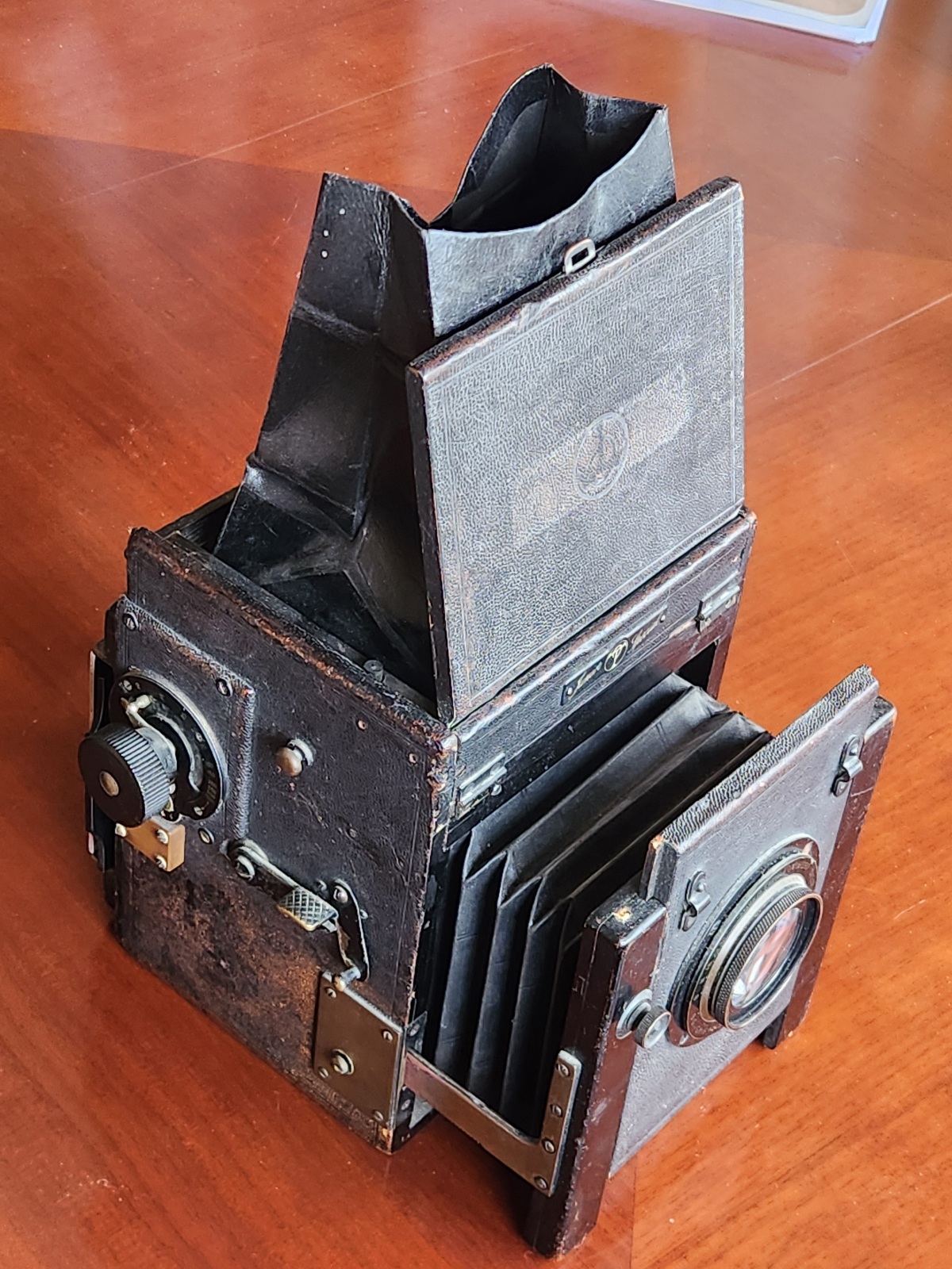

Sorry to bring this back from the dead, but did you by chance happen to finish this restoration or have any other updates? I've got the same camera with a beautiful 14 aperture blade 6" f/3 Aldis Anastigmat which seems unusually fast for the era and format. My plan is to put a polaroid back on it and make it a dedicated Polaroid SLR since it's exactly the right size for peel apart and infinitely lighter than the Graflex Super D I've been using for the same purpose.
