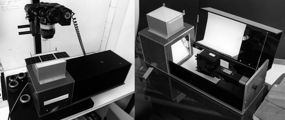

...not sure why you would have alignment problems - when using vertical copy stand this should be straightforward using a mirror. Rather than an interneg/contact, why not reversal procesing? That will save a lens/film combination. I used this arrangement (image) for making 35mm slides from b/w internegs (colour slide duping was also possible). TTL exposure with a Nikon
F3 camera and Metz 60. No worries about extn factor, camera shake or wrong colour temp. I think the flash exposure also softened the contrast because of HI RLF.

..i thought a photo of a viable slide duping and internerneg system would help you. You really do need a copy stand and flash lighting to do this well.
There's nothing as compilcated as colour-seperations going on here though. Colour slide films were 'duped' onto Ektachrome SE low contrast duplicating film (not sure if it's still available).
Internegs from b/w originals probably went onto Pan F. Black and white slides from b/w negs went on to Eastman 5363 fine-grain Release Positive (a blue sensitive, motion picture, negative film stock).
The purpose-made 'illuminator' houses a Metz 60 flashgun, whose power is controlled 'TTL' by A NIkon F3 fitted with a 55mm Micro-Nikkor. Light is directed into the 'folded-light' reflex box, containing a 45 degree reflector and a pair of fluoresent modelling lamps for viewing and focusing. The 5x4 in stage ontop was taken from a Bowens 'Illumitran'. Alignment was tested using a mirror placed on the 'copy panel' - then focusing the cmaera on it and ensuring the image of the Macro lens was seen to be in the centre of the viewfinder (just normal alignment technique). The 'device' was made in 1986/7 and used for about 15 years - until digital systems came along. IIRC you had to 'gaffer tape off' the Metz's built in sensor (not TTL) because the high light intensity in the illumminator could cause it to fail (then the flash would fire at full-power all the time). Maybe you can source some used equipment to do your duping job, or get something specially made. Hope this helps.
